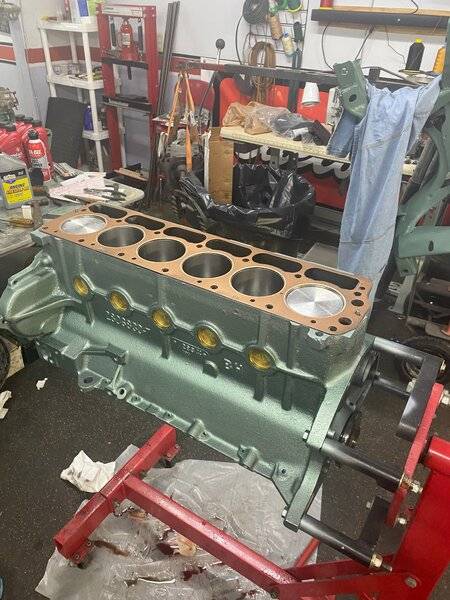

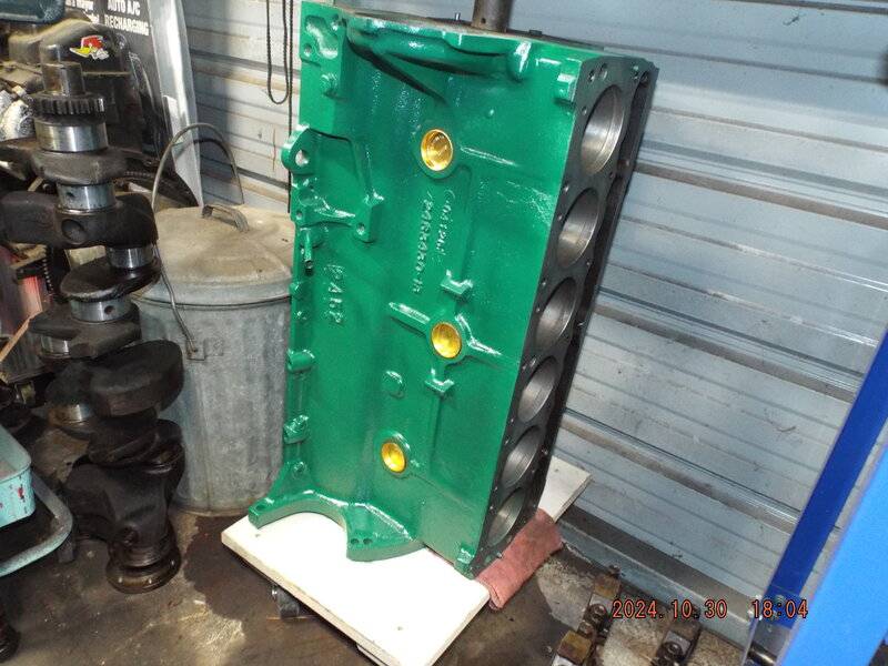

Got cheap & nasty's freeze plugs in today. The brass looks cool against the green. I sealed them with Permatex #2. Just to give yall somethin to argue over.
Just tell me you aren't taking the cheap part so far as to skip the Plastigauge. :p
Going to port any oil or water passages while working on the block?
Naw, it's gonna get plastigauged. No plans on porting anything.
