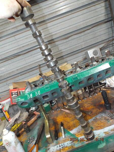

Cheap & Nasty has a camshaft. I was able to salvage the camshaft that actually came out of it originally. Hit the lobes with the wire brush on the bench grinder and polished them with some 400 grit emery cloth. The fuel pump lobe has a little bit of a trench worn in it but as they say, I'm gonna send it. lol
So I've been thinkin on it and even as cheap & nasty as this project is, I couldn't in good conscious use that camshaft with a half tore up fuel pump lobe, so I picked a much better one out and cleaned it up instead. It measures in at .405" lift. At least this way, I will start the project with the stock mechanical fuel pump. I'm pretty sure, if all goes as planned, I will get it running good enough to easily surpass what the stock pump can supply, but at least this way, I can use what I have right off the bat, without having to build another fuel system. I'm going to have the original lifters refaced. @replicaracer43 Sean has agreed to do the job. I'll be sending those off to him first of next week.
Good call, I`m all about cheap but I wouldn`t use it either.
That cam would be a good candidate for a weld it up and grind it back down, and see if it caused any runout from the heat, experiment.
Yup. After looking at stock camshaft specs, This one is likely the last version of the solid lifter cam which was .416 lift. I don't think it's worn that much at all. I measured it with a dial caliper, so I'm sure I errored it up. lol At any rate, this is what it's gettin. It may be all done by 4500, but hopefully it'll get there quick. lol
