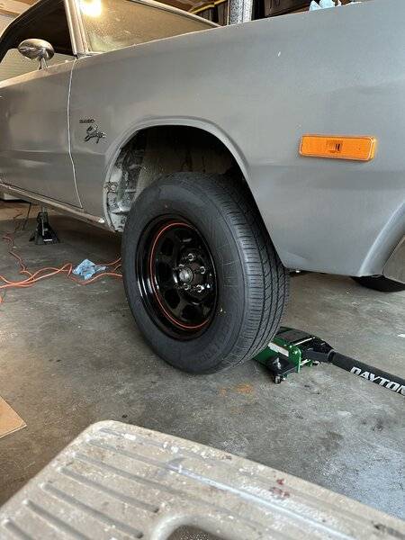

Got the new 15x7 Bassett wheels and 215/65r15 tires for my birthday. Just installed the Moroso 3” studs. I know this is not everybody’s cup of tea, and I’m not even a big fan of NASCAR but I love the way this looks.

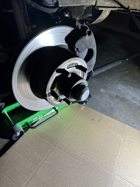

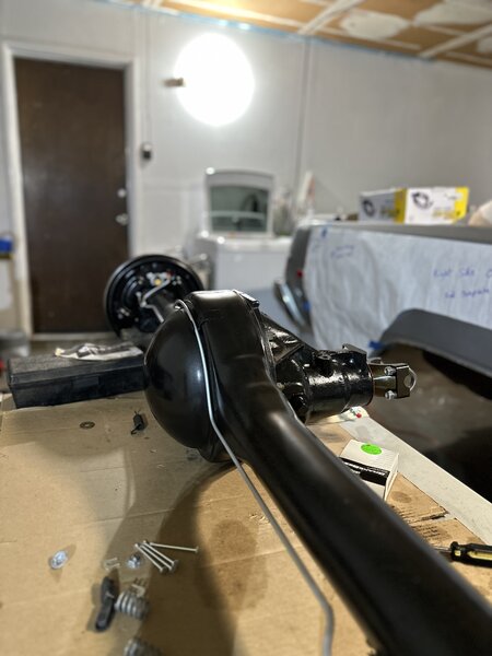

Midnight madness, these drum brakes put me through the wringer trying to get all the hardware to work. I had to swap the shoes twice at the parts store due to not working with the parking brake lever. Finally I had to replace the pins in the shoes to work with the parking brake hardware.

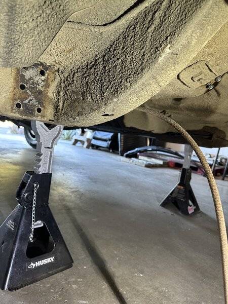

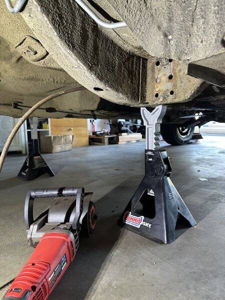

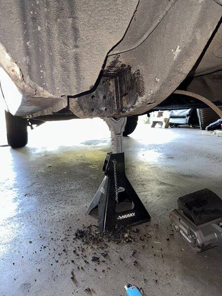

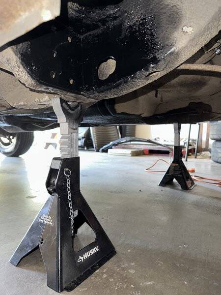

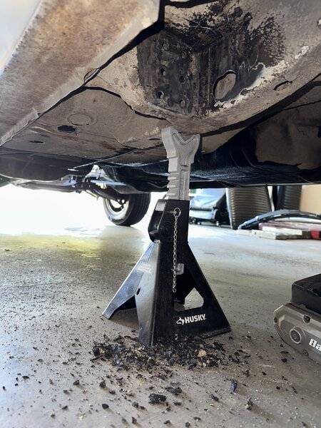

Offset spring hangers installed, just waiting on Mancini for the hanger nuts and I can bolt the 8.75 in. Had to break out the torch and scrape the undercoat on the drivers side.
