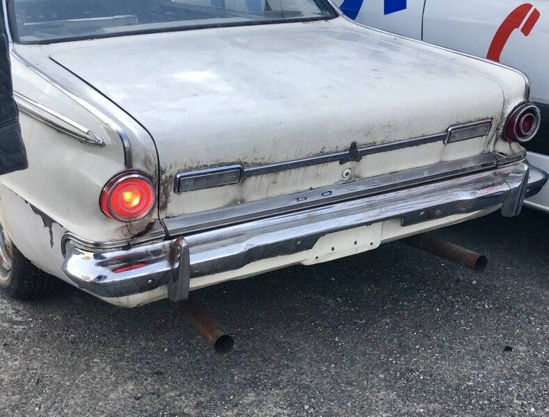

Here’s a snapshot of the rear, dual exhaust. This is from back in 2020 when my dad was attempting to start the engine without luck, at least one tail light was working :lol:
One thing is for sure, that car is in need of a lot of love.

Wait til you see pics of my sled lol. Interior held together with safety pins. Body, paint ? No way.
