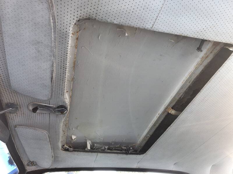

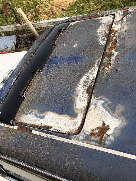

What is on the roof? Does this thing have a sunroof?
Yes it does :) Came from the factory with the sunroof, one of few with that feature.

maybe dealer or aftermarket installed. to my knowledge dodge only started offering factory sunroofs in 69...
Yeah I agree. That's my one cardinal rule with any car. Don't buy one with a sunroof. lol

Was the sun roof factory, dealer installed, previous owner installed. What does it matter. It's there.

Looks like the car was originally blue. Probably an import.

I'm going off the primary color on the fender tag, as well as the rub though on that sun roof.
And I'd have to hazard a guess that Norway wasn't building Mopars in a factory back in the early 60's.
Nice thought, and observation. Look a little deeper it was white.
Look at the blue flaking off the white base on the fender tag.
Good observation though. A for effort.
