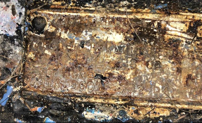

Exactly just as the rest of the car. It could totally be something "rare" as we've seen no fender tag. Being what it is over THERE really makes it somewhat rare already! But race engine? Nah. Thing about it is, Even a stock small block in that would give a GTO what for.

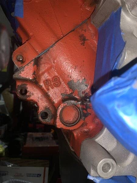

I haven’t read the whole thread yet but first thing, welcome aboard.
Second thing about the race block…
No you don’t have one unless there is a letter “X”, “R” or a “R3” located in the picture below. The early race blocks were cast with the same numbers as production blocks.

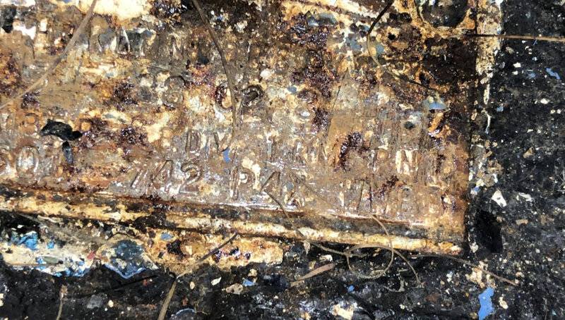

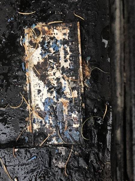

In terms of the fender tag, it’s been very challenging trying to decipher what’s on it due to dirt and paint that had to be scraped off. I can make out a few digits but nothing comprehensive. Is there anything I can apply to it to clean it up?
