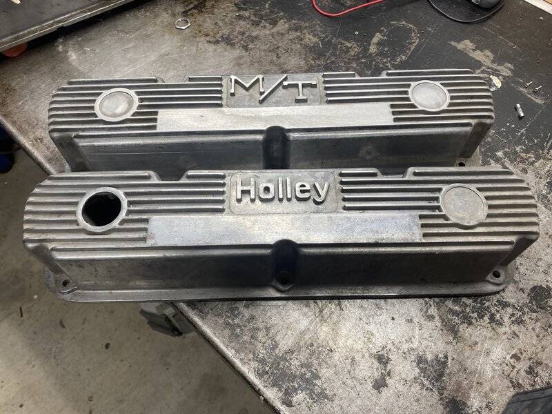

Thanks to marketplace I’ve become a smallblock valve cover collector. I had to have the Mickeys as my first 340 sported those covers back in the 90s. I’ll be painting them corporate blue just like back in the day. They’ll join my Direct Connection one on the wall. I’d hang one of my MP wide covers but I’m afraid they’ll bring the wall down

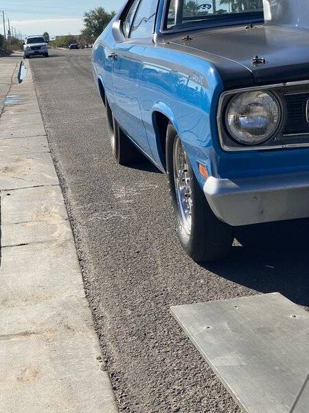

Wasted an absolutely beautiful morning getting the front end straightened out, but we got her happy again. Luckily the alignment rack at work was free to play on. Busy couple of weekends and it’ll be December before we know it.
Not technically wasted as you accomplish something. Was it out very bad. Now in your head you know it’s ready to go.
Well ever time the K is removed it moves it around a bit. The right side I did have to shorten the lower control arms three turns on the heim ends to allow the upper adjusters a window to achieve good numbers. I REALLY had to force myself to get this done. Between holidays and work schedules this was about the only window I had. Spent 2.5 hrs on it.
