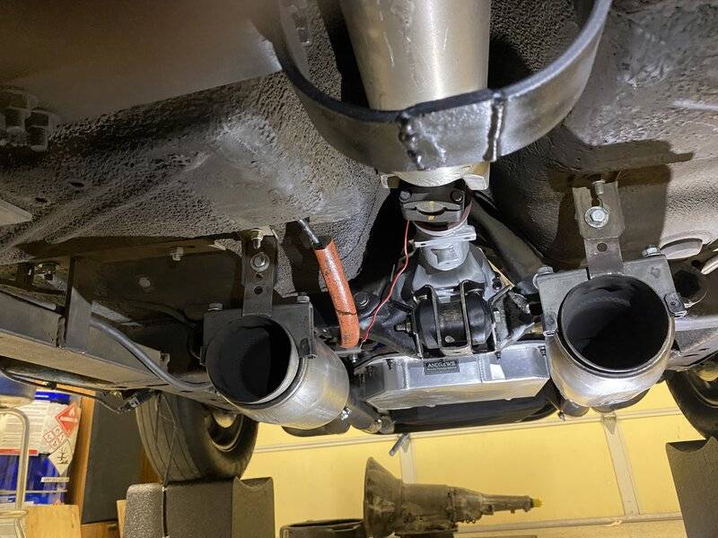

as a bracket guy this was probably the crossroads where I should have followed the masses and went “glide”….. but here I am!! . Was nice to meet up with Chris and hopefully I’ll find the power to get my lazy a** under the car and swap away! It was not an upgrade for the faint of heart ($$), but has all the upgrades for reliability behind my small block. I was going to have it built with no t-brake and just swap in my Pro-Trans one, but in the spirit of lazy/ease of swap I’m now a first time A&A trans brake owner! I’m also considering having another converter built to see if we can go back to the slower, but more consistent 60 times.

Yeah I found the “unobtanium“ output shaft, so I was going to buy the matching input and just upgrade my current 904, but then just said eff it and sent him a core and a few parts I’d bought from him and had a unit built. Looking forward to getting back out after the oven months.
That's the way to go. I hate the oven months too.

Well….. get in the garage at 5 am. Opened all the doors as the outside temp was slightly less that inside. I’m not sure a trans r/r has EVER gone so smoothly. Everything clicked!! Converter swapped over and slid right in. jacked trans up (I use a Craftsman motorcycle jack) and it FELL on the dowels!! Just have to order some flex plate bolts (thought I had some…. only use them twice), and some fluid. Guess I could have put the driveshaft on but I got a good two months to button it up. 114 out, 92 in the garage….. it pool time.
I run a “stud/nut“ configuration on the right side. Allows trans removal and leave the oil filter in place.

Well we’re to the just add fluid and check line psi stage.…. as soon as cheap mopar guy orders some fluid! I’ve always had a supply of ATF4 from work, but we’re going with some “race” recommendations this go round.

Well if there was any question to my sanity / stupidity I drank heavily and hit “buy it now” for some trans fluid. It’s not easy for a mopar guy to make such purchases, especially when you’ve had “free” from work since the beginning of time.
….and yes, I have a 727 torn apart. I was “persuaded“ into checking out this unit. While I don’t like doing this for others (no good deed goes unpunished) i decided to take a peak.….
very few passes on unit and looked pretty good inside. The .120” end play and .090 rear clutch clearance was a bit disconcerting. Old T/A manual valve body, 5.0 band lever (who does that anymore?!?), billet kickdown apply piston. AND of course it‘s now snowballed into a trans brake build with a billet front drum. Honestly if he balked at the drum I’d a had him come pick up his box of parts. Found my old Mirada 727 notes so I guess I’ll take a swing at this. At least I can keep the shed at 80-85 degrees if I run the A/C bright and early in the am.
