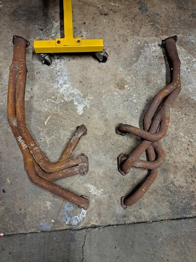

@RogerRamRod Here is a pic of one of our "off the shelf" RHD headers - options are pretty limited

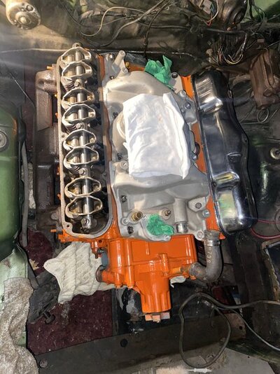

Up till 2:00 am with the engine hoist so I could close the garage door but my 360 crate is in its dirty home(71 Demon).
Just have to put all extremities on.
Should make a fun little s#!tbox.
