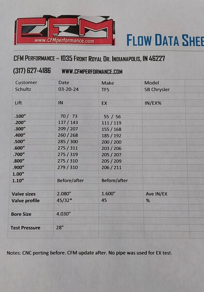

Looking to install a new camshaft in my 408. Trickflow heads cnc ported, molnar crank/rods/icon pistons 12.25 to 1. Current cam 287/301 660/660 lift with a 108 lobe seperation at .050 254/268 and .440/.440
3350lbs Duster with 430gear and 29” tall tire.
Curious what everyone is running and which lobe seperation they find or found works best.

Sorry forgot to add the heads have a 2.08 exhaust cable

I can see needing more camshaft if the goal is for the engine to rpm higher. Did you have the heads flowed after installing the 2.08 intake valves and how much lift will your valve springs support?
Yes heads were flowed and springs good to 700 lift per Trickflow. I am having the heads reworked and will check spring pressure.
Nice work! I’ve been curious what a set of TFS heads could do with larger valves and corresponding seat and throat cuts.
You’re having the heads from that flow sheet reworked more?
No, sorry did a leak down test and 4 of the exhaust valves leaked causing lower pressure in the cylinder. So, going to fix the heads, pick out a new cam, verify spring pressure and replace valve springs if needed. Card off to paint, so looking to continue what Bill started! Going to get a different converter too.
