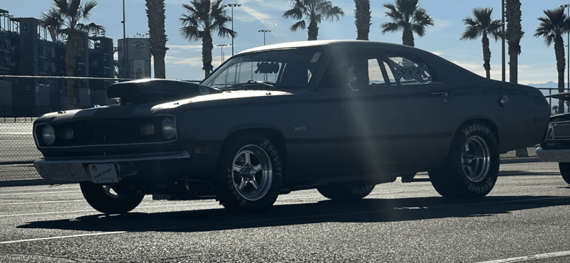

I think you mean Bullet and yea they’re pretty good. At this point you’re going to be moving power around more than making a bunch more. That engine has a pretty healthy cam in it already and I’d be surprised if there was a bunch more to gain. You said you’re ordering a converter also, I think that’s a good move but be careful changing too many variables at once you’ll never know which one did what. I’ve got a bunch of good photos of that car from vegas.

Looking to install a new camshaft in my 408. Trickflow heads cnc ported, molnar crank/rods/icon pistons 12.25 to 1. Current cam 287/301 660/660 lift with a 108 lobe seperation at .050 254/268 and .440/.440
3350lbs Duster with 430gear and 29” tall tire.
