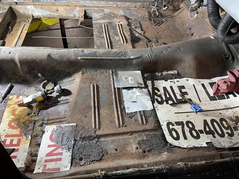

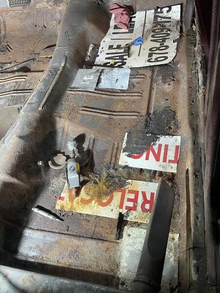

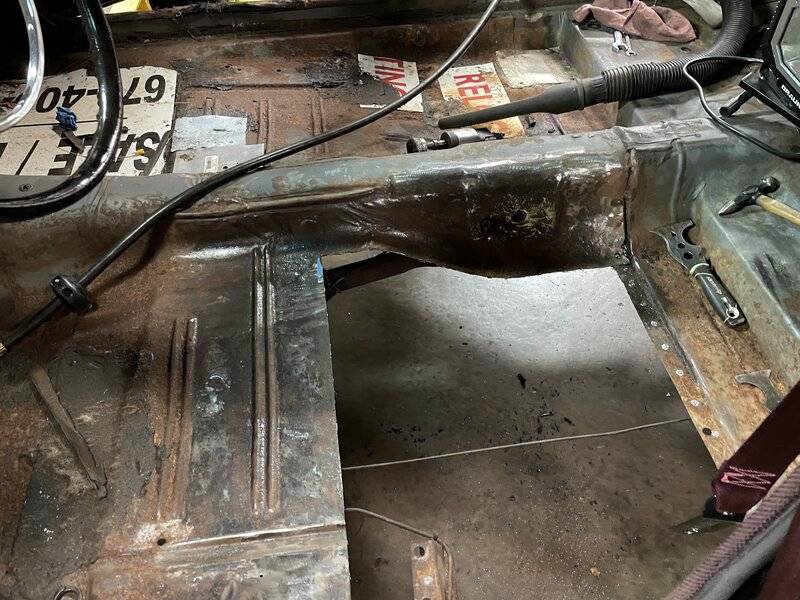

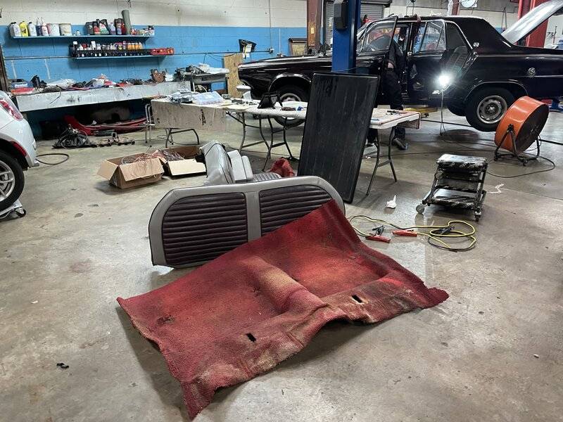

Floor pan repairs have started. Ordered the auto body specialties stamped pans. 18 ga steel, good quality pans. They are damn near identical to the original pans that we’re cutting out, just a whole lot less rusty. After this, I’ve got 80 mil Kilmat for the entire floor and door panels, and ordered 525-Maroon carpet from Stock Interiors. The old carpet is nasty.

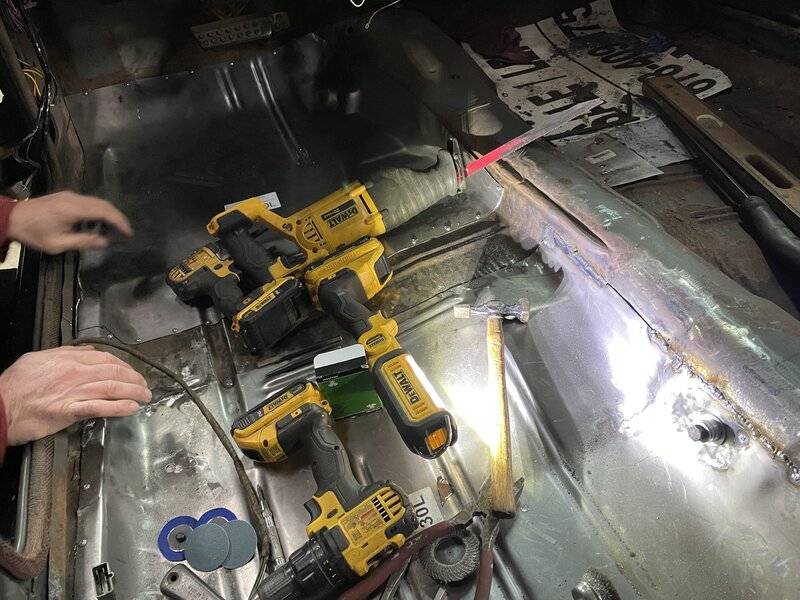

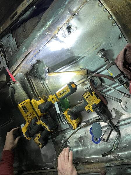

Here are some update photos with the first section in. Seam sealer between the old and new panel, screwed in, then spot welded at each hole created by the screw, and then the seams are being welded. It’ll be solid. All of this will get painted, then have 80mil Kilmat applied over it and the underside will be painted too.

Are sure this is not an advertisement for Dewalt power tools? LOL
