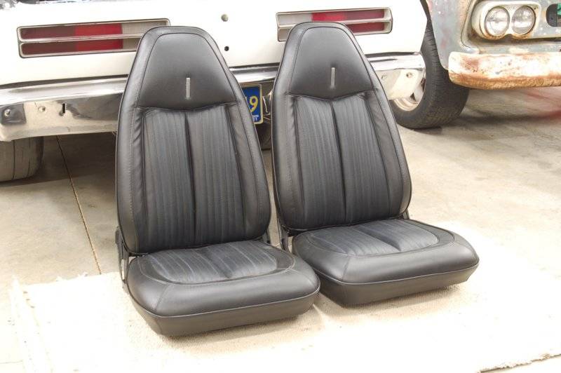

I found a pair of Duster seats on Craigslist and had them recovered. This should be one of the final touches.
So are u cutting holes in them for the 5 point harnesses? Kim
Nope, I have a race seat in the car for the driver and the passenger will get a factory bucket. The original driver side bucket just goes into storage.

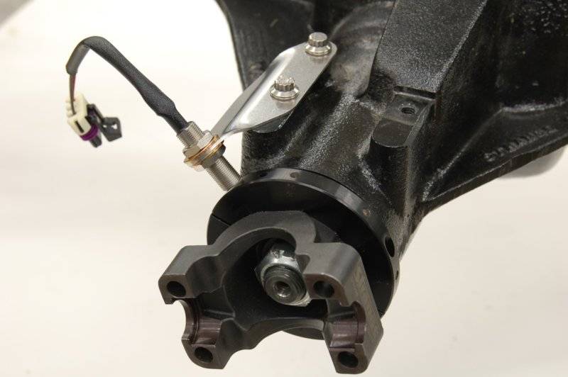

I also hooked up the driveshaft speed sensor and took the car for a drive. Kind of cool watching both driveshaft speed and engine speed on the dash. I programmed the dash so I had both RPM gauges next to each other so it was easy to watch them. In high gear cruising down the road there is about 3% slip. I'l have to data log it so I can watch it in different gears and different throttle positions but for now I just watched it on the dash.

Had a custom bracket made to mount the G Meter sensor to the roll bar. It came out nice.

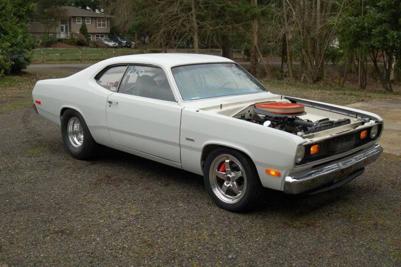

I weighed the Duster today after taking it out for a drive. 3150 lbs ready to go. I'm around 200 lbs so 3350 with me in it. Car is 52% front and 48% rear weight so not too bad. Be nice to get it closer to 50/50 but I'd have to take some more weight off the front to get there. I suppose a glass front bumper would help but I drive the car on the street so I probably won't do that. The engine is already pretty light with lots of aluminum parts.
I haven't taken it to the track yet but I've rolled into the throttle a few times on open roads and it sits up and goes. The Moroso slide rule says it will run low 10's at 130 mph at the track but I don't know if it will hook up well enough to do that. I'll find out later on this year when it gets a bit warmer.

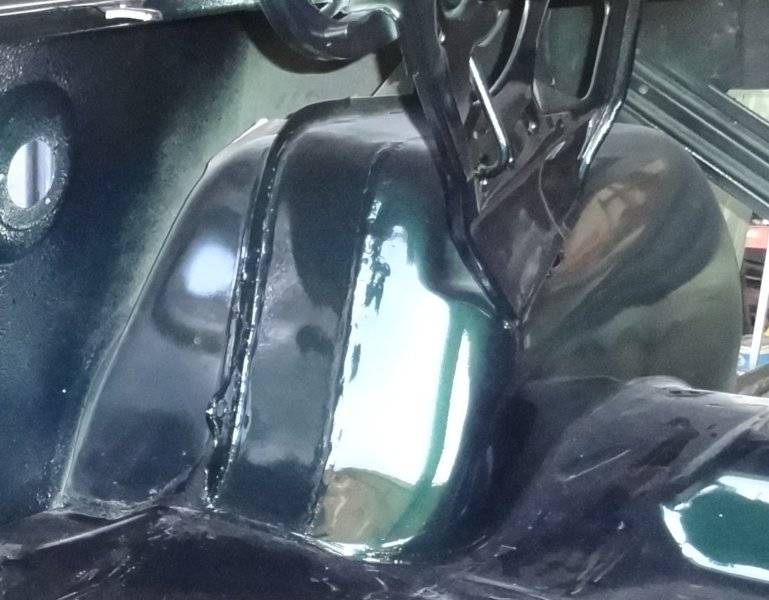

325s fit with ease... A few pictures of the process and an old picture with a 325/50-15 before clean up and paint. The launch was butal and the 1-2 shift put the keys and the key cylinder in the back seat on my first test drive with 325 drag radials. With the 295s I'm using now to roll the car around the garage I have about 2-1/2" clearance on the inside and 1" on the outside. I am thinking I will run 325/30-19s when I am done with plenty of room.
