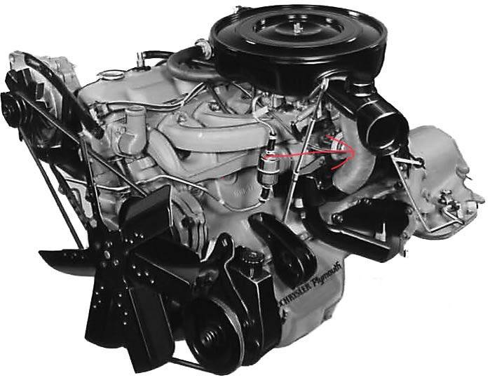

Choke coming off too quick would be my guess. Check your accelerator pump shot also. That kind of hesitation is usually a lean condition.She just likes to die if I don't let it sit and idle a while.
It’s a slant, right? They really want to warm up before they go when it’s cold. Do you have the heat tube to the air cleaner from the exhaust mainifold? I always found them to make a big difference to heat the cold air and make it go better when it’s cold.She just likes to die if I don't let it sit and idle a while.

Yep, she is a slant. And ya know... I have no idea about the heat tube. I will have to look, but I doubt it.It’s a slant, right? They really want to warm up before they go when it’s cold. Do you have the heat tube to the air cleaner from the exhaust mainifold? I always found them to make a big difference to heat the cold air and make it go better when it’s cold.

Yep, gotta warm it up.It’s a slant, right? They really want to warm up before they go when it’s cold. Do you have the heat tube to the air cleaner from the exhaust mainifold? I always found them to make a big difference to heat the cold air and make it go better when it’s cold.

A properly operating choke is VERY important.. And if you can make a preheat tube to the air cleaner function, you might find it bearable... But I've found my slanty is still a bit cold natured..Yep, she is a slant. And ya know... I have no idea about the heat tube. I will have to look, but I doubt it.

It goes here...Yep, she is a slant. And ya know... I have no idea about the heat tube. I will have to look, but I doubt it.

Up here the “stove” is important.

and then make sure the flapper in the snorkel opens when the engine is running.

Googling it as we type lol!and then make sure the flapper in the snorkel opens when the engine is running.
It's vacuum 'motor' that opens the valve. A thermostatic valve will know to close the flapper when the air termperature gets too warm.
