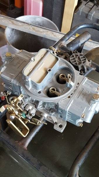

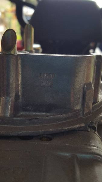

Do I just plug the other side then? This set up is different than the old Holleys I've got experience with
Not unless it has a fuel transfer tube from one bowl to the other...
The rear bowl will not get fuel if not...
If it's set up for dual feed, then you need a dual feed fuel line...
If it's set up for single feed, then it will have a transfer tube between the two bowls...
I only have the one side But it shows the list number

Show us a picture. Both sides.
This is just a random pic off the internet but notice on the fuel Bowl the inlet looking tube that angles down from the float adjustment screw? There's one on front and back on each side, one side of each is set up for the inlet but what stops it from leaking out the other side?
I’ve got Chris on ignore and I can still guess what he’s asking by the responses.
The duel feed Holley is set up so you can put the duel feed fuel manifold on either side depending on the application. The side you aren’t using gets threaded plugs to block them off. You buy the duel feed manifold that best suits your application and clearance.
