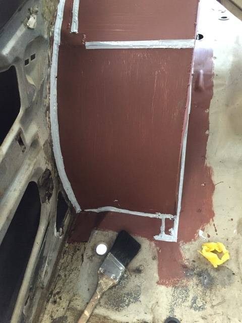

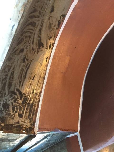

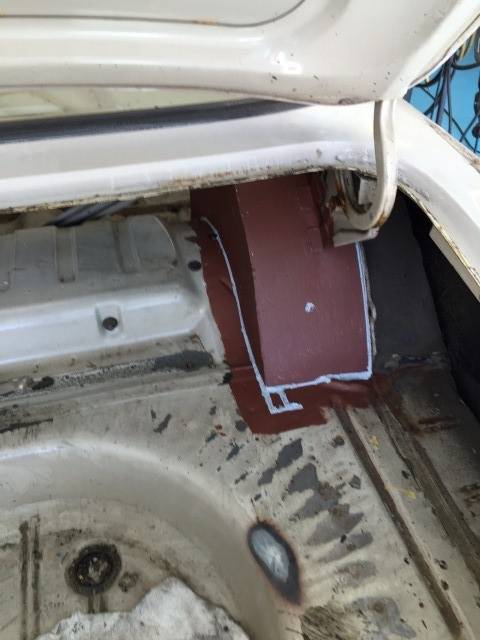

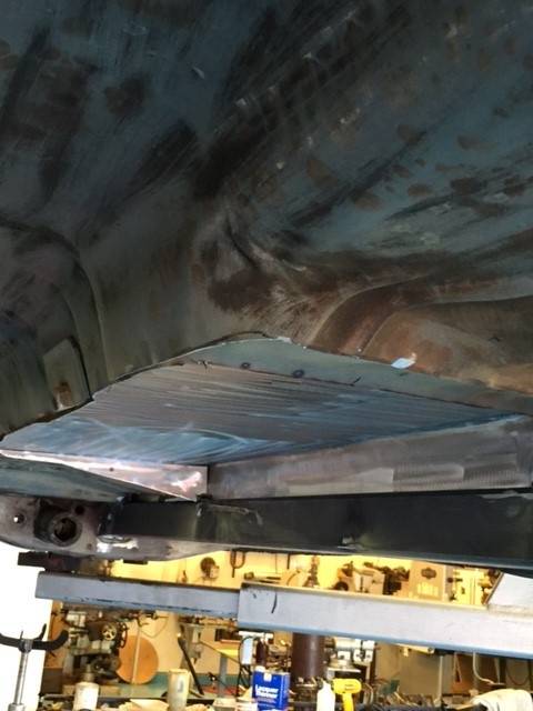

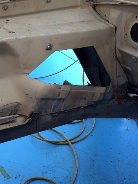

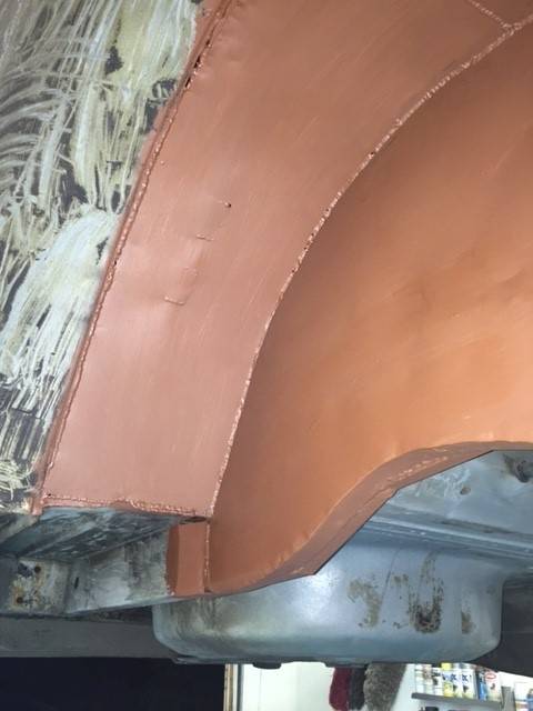

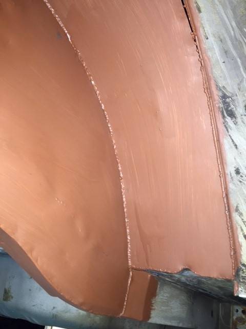

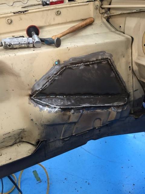

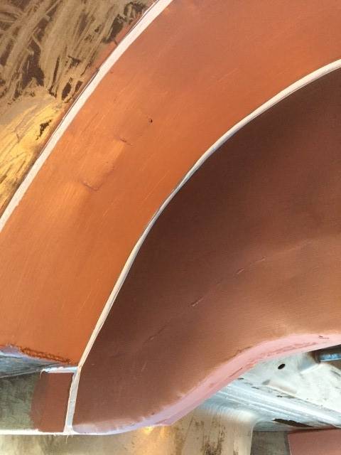

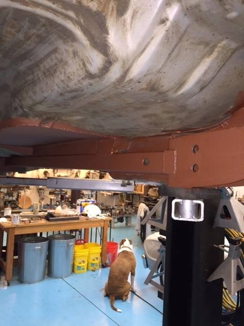

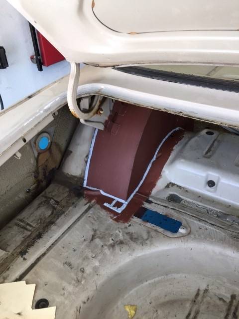

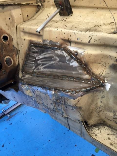

Mini tub construction is complete. Applied red oxide primer and seam sealer.

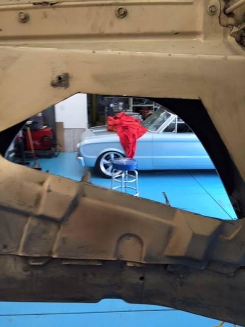

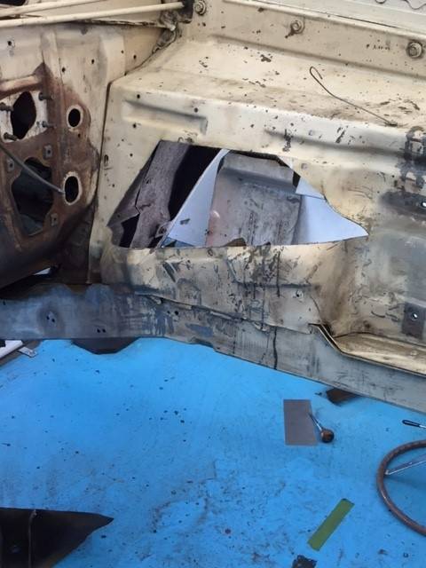

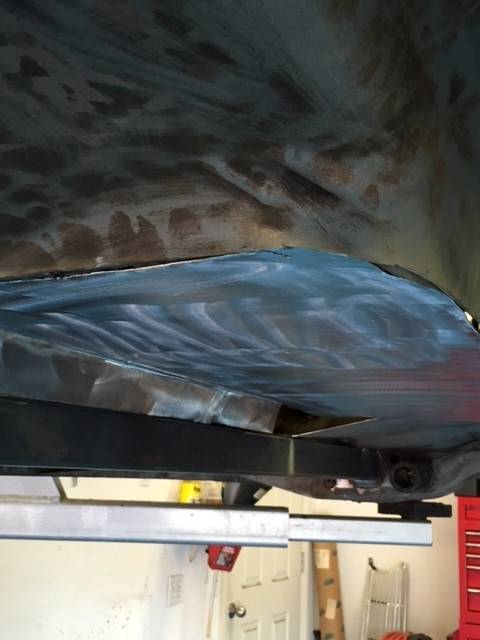

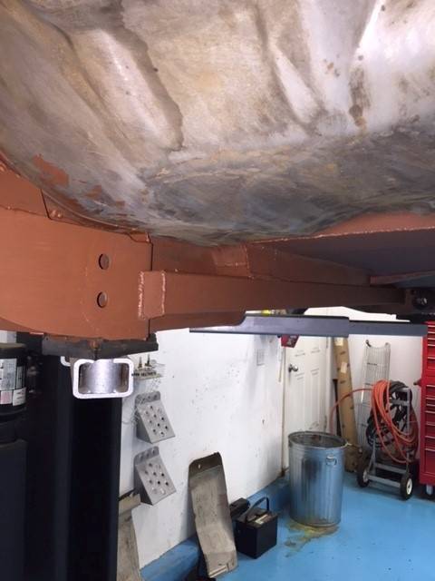

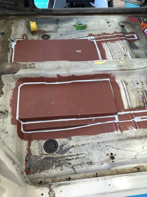

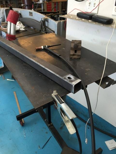

Fabricated sub-frame connectors and raised part of the floor to tuck in the exhaust. I used 2" X 2" X 1/8" thick square tubing. Cut the floors and attached the connectors to the floor. Ran "conduit" for main battery wire and fuel line.

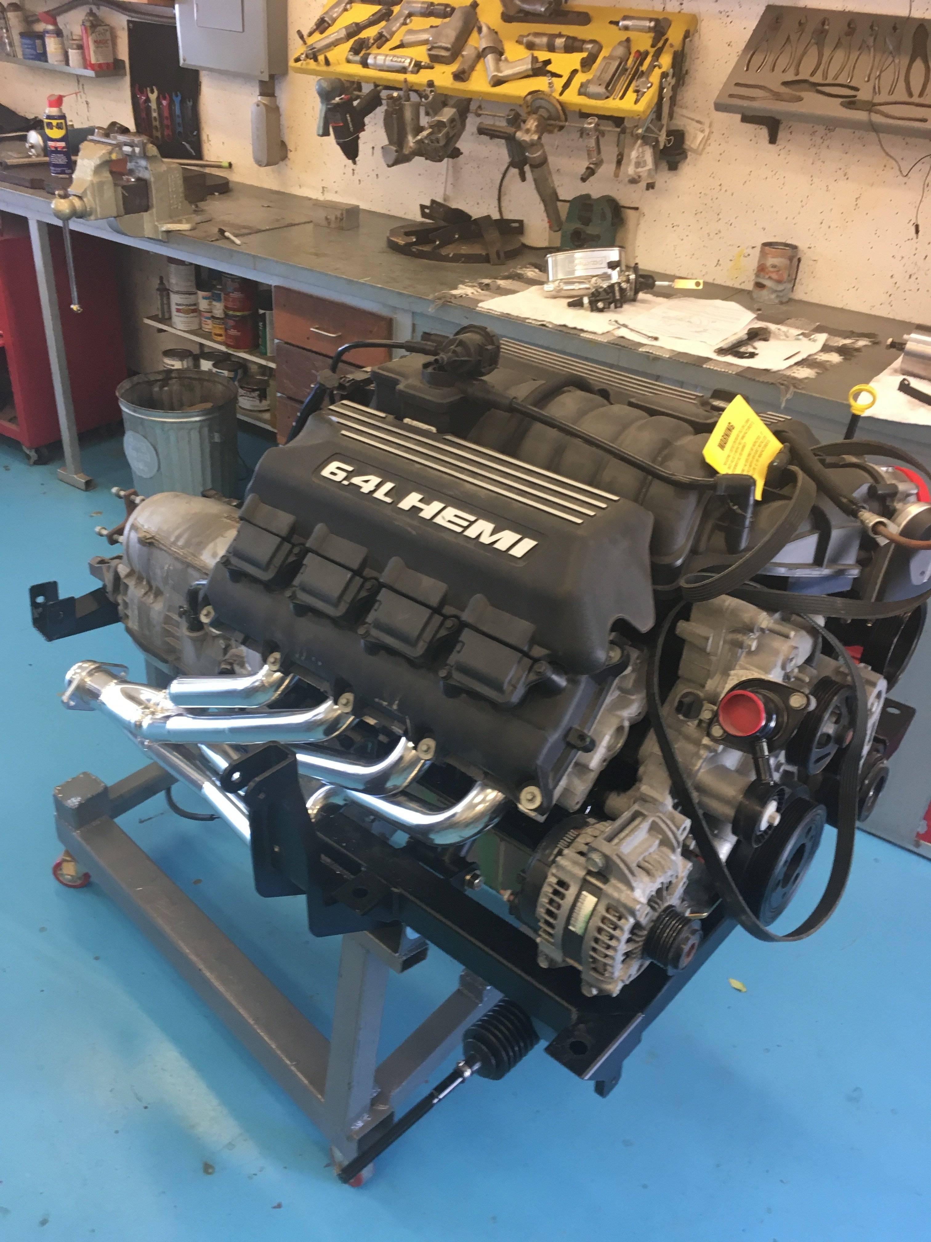

Sub frame connectors are installed/welded! There are no headers available anywhere for this swap. Going to build my own.
how you going to control that trans? i believe your only option is HOTWIREAUTO.com
I used them for my 6.4 545rfe swap...
