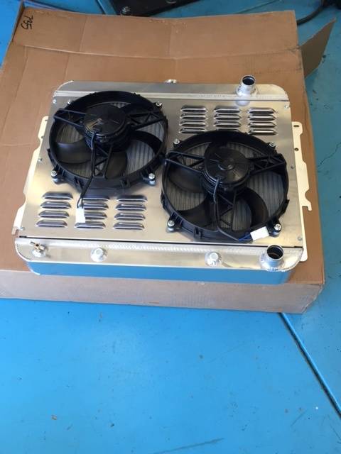

On all of my projects I like to cut out the top of the radiator supports and make them "removable". It makes engine installs much easier, especially with the transmission connected. I plan on installing and removing my motor and trans from underneath but not everyone has a lift.
Looks awesome! If you haven't put the hood on temporarily to check clearance, it might be a good idea. It would be awful to smush the fill neck of that purty new radiator! :mad:

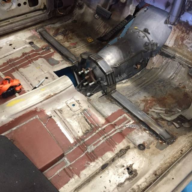

Cut out the entire tunnel. The NAG1 wasn't even close with the stock sheet metal.

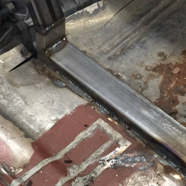

Since I had to cut out the upper factory reinforcement to fit the NAG1 as well cut out the lower support for exhaust, I had to fab an upper support that tied in to the lower support.
