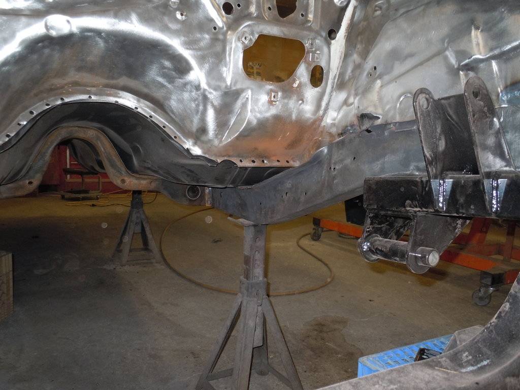

I spent a lot of time researching a rack and pinion steering assembly and can tell you that most of the suppliers I dealt with were not great and, after talking to people that used their products, I found the after sales experience was worse. By far, the best Company was RMS Suspensions and exceptional quality with beautiful welds and top notch components.Also, the owner Bill Rielly was always readily available and helped sort out any issues I had immediately. This front end kit is very strong yet much much lighter. I can pick up the whole assembly including the brake /spindle assembly/power rack /k member myself. Try doing that with the stock stuff!!

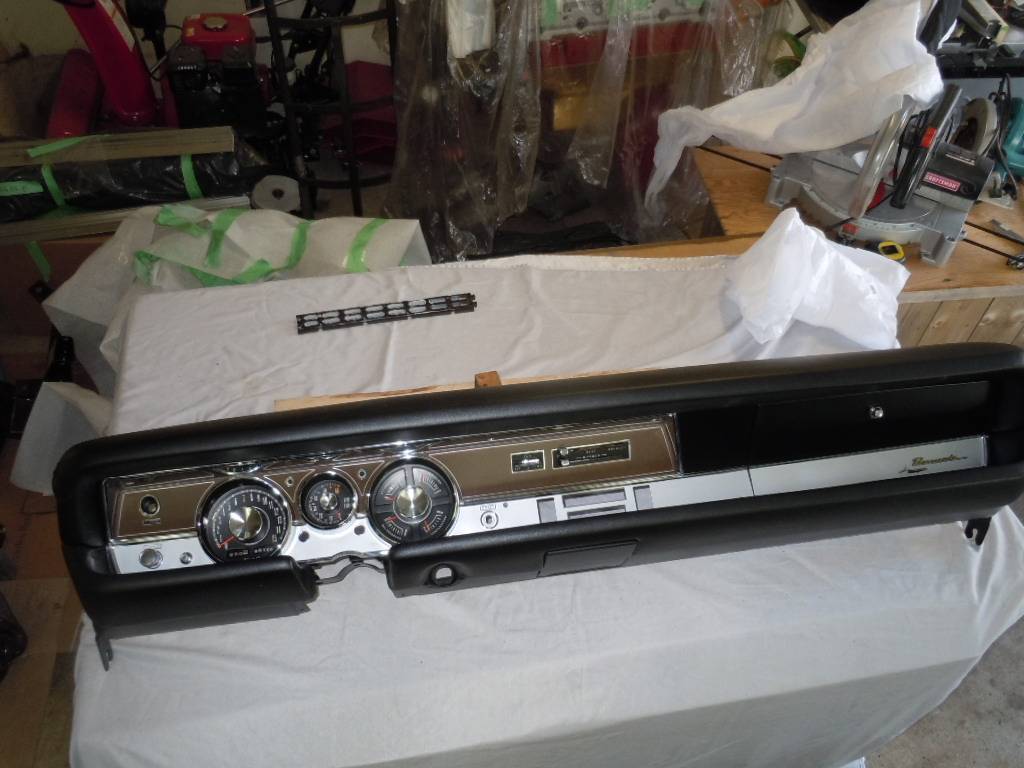

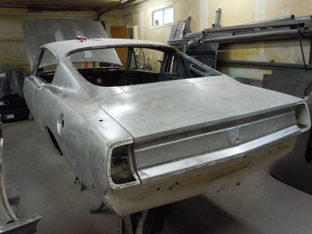

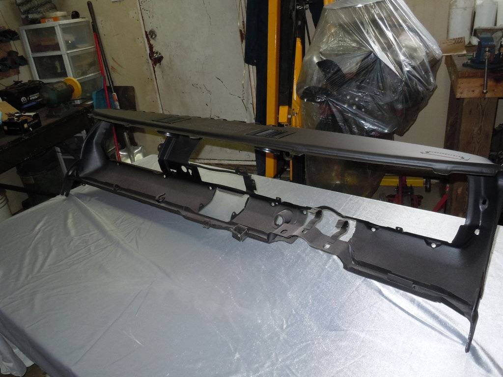

Hi fellow FABO members.
Thought I'd share some pics of my car. It's my first car, bought in 1977,got my drivers license on it and have had it ever since. Time and money have kept it off the road since 1999 but it's almost completely restored at this point. Some of the highlights are RMS front and rear suspension,4-speed conversion,360 Magnum engine (500 hp), 2.5" TTI exhaust , United tool works sub frame connectors and torque boxes, complete white legendary interior with rally seat upgrade , all chrome and stainless replaced or refinished. Full rotisserie resto including painting and clear coating full undercarriage.
Hope you like it.

amazing effort and accomplishment!! is that an AMD floor pan?
Thanks A56!!
Yes, it's an AMD floor pan. Also used the front and rear valence panels, the lower rad support and the 4-speed tunnel.
Top notch parts ,great fit and great service.

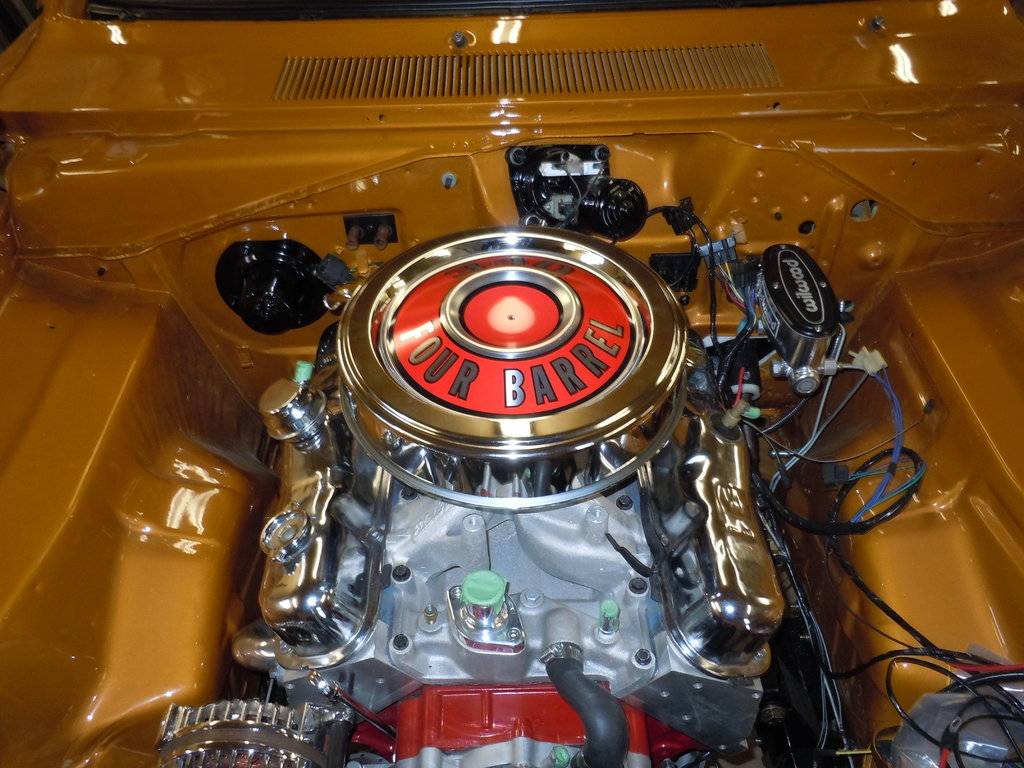

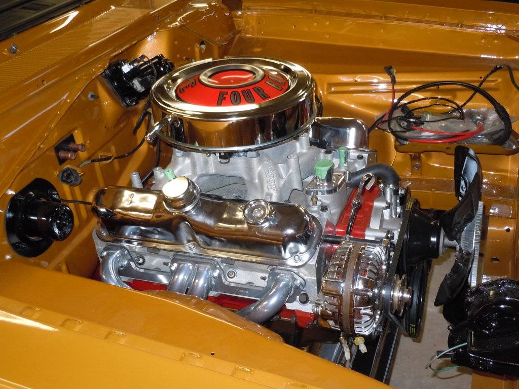

Here's some engine pics. BTW, for those considering using RMS front suspension and k-member, I had to alter the Milodon oil pan a little to clear the steering rack. I'll post pics of the modification as soon as I can.

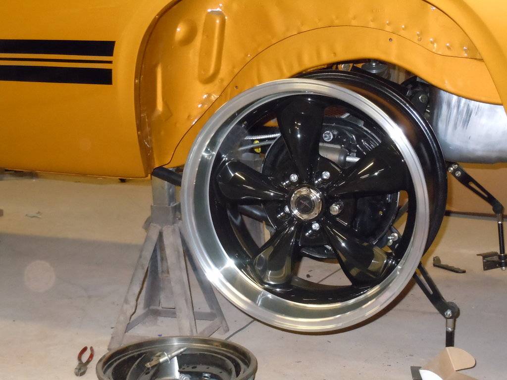

Here's pics of my wheels. I thought I'd post this as I've seen so many posts requesting what is the max size wheels that you can use on a Barracuda like mine with the Alterkation front end and the Streetlynx rear suspension from RMS.
Front Wheels: Torq Thrust Model AR105M 7765B 17 X 7 0 Offset , 4" backspace.
Rear wheels: Torq Thrust Model AR105M8966B 18 X 9 34 Offset, 6.34 Backspace

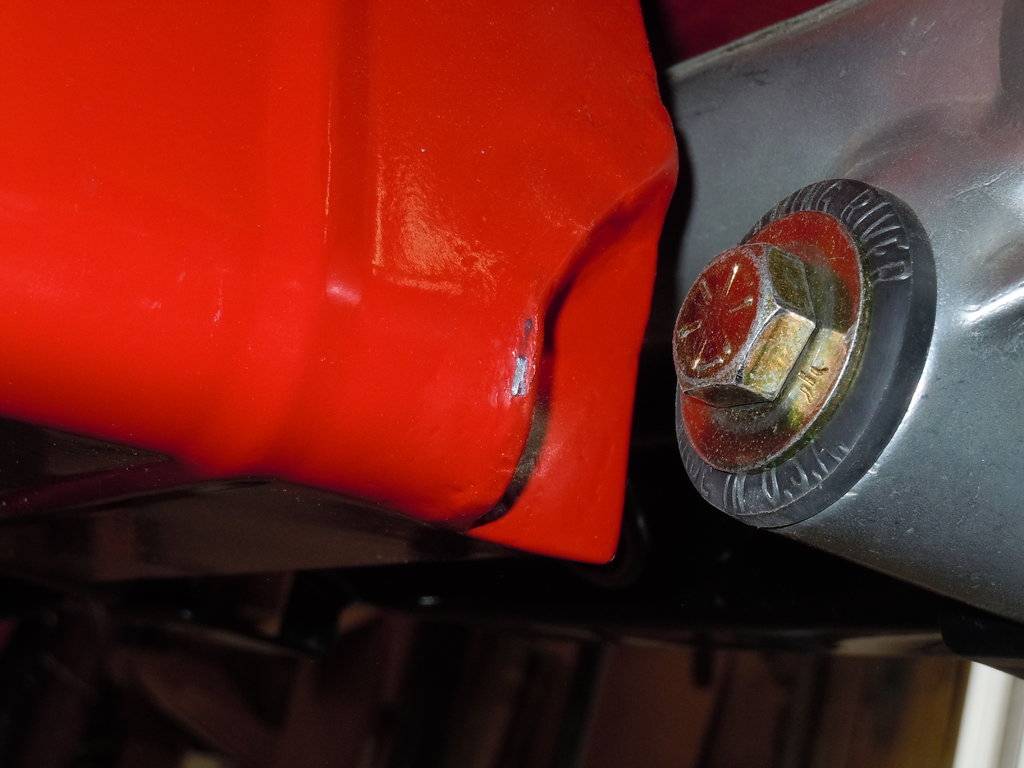

Hopefully this will help someone else. As well, there's a pic of the Mildodon base pan modification for the AlterKation K-member for clearance for the pass side rack mounting bolt.
Hope this is of some help to anyone considering doing the same mods as me.
