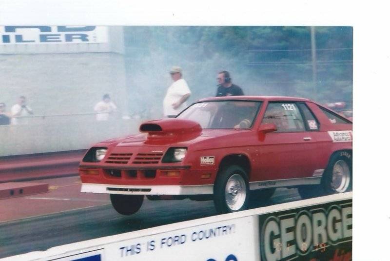

The s/s springs I have laying on a bench, I bought off of Jim Hale , he had them on a nhra stock class 383 barracuda," ultra first class car" , he told me the caltrac system (he went to) didn`t hook up or go any faster then the 002-003 springs, but the car was less violent and easier to drive----??? but, he ran slicks and had way more initial bite than my drag radials, "which could be too far along" for a higher h.p. motor. He had pics of the front end in the air about yours with the s/s springs.
All these kick a$$ pics are on well prepped tracks , with strip gearing. I have street gearing in mine -------------

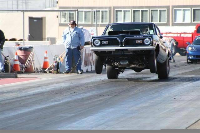

cal tracs, splits, ranchos, 275dr, SB 560ish hp, 3300#, 1.41-1.43 60's 10.60, 124
Just one car that proves otherwise. With Afco rear shocks it's gone 1.37's 60's and 10.53 - 125+.
