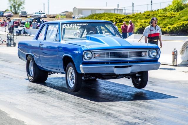

Sorry I was hard on all those that run Cal Tracs.Last year was very frustrating. I wish I left the car alone (SS springs/snubber).
With all due respect,I finally came to the conclusion if you are determinded to make them work,it is going to take much more hardware then what Calvert sells you. In my opinion it takes sliders, Afco shocks,tubes, more rear tire pressure, as much front end travel you can get, and leave soft as you can.Adapting longer mono leafs will help a whole bunch too.
Now this is fine if you want to stay leaf springs. But the bottom line is, for what all this costs (including the Cal Tracs themselves) you can ladder bar a car, and it's going to work better straight away.
My issue is, I was under the impression they worked pretty good out of the box, and better then SS springs with a snubber. They didn't. I was racing seriously for Summit series points, and other then 1 day of TT's there was no other time to mess with them.They are going to take work, I admit that now.I can see you can more or less make them work.
If you are one that wants to go play with your car, and just have fun seeing how fast you can go on leaf springs, they are for you. If you want a consistant car right of the box, and don't want to fiddle with it, stay with the SS springs and snubber. If you want to go serious racing, back half it, or atleast ladder bar and mini tub it.
I decided to take a short cut myself.The Valiant is for sale if you want to go Cal Trac Racing.
