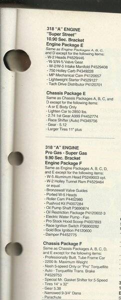

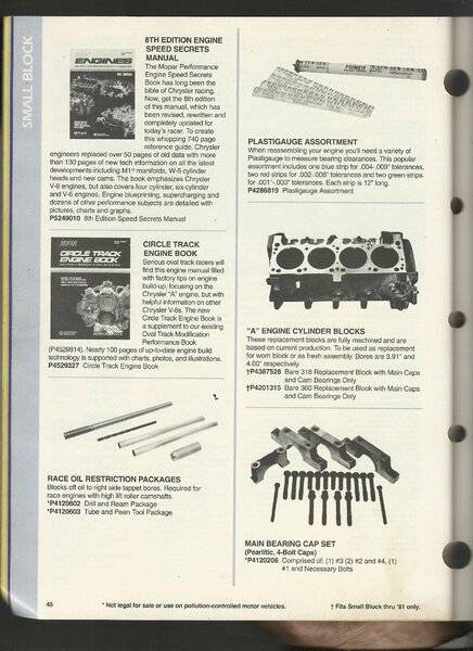

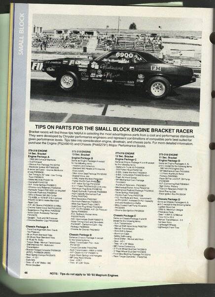

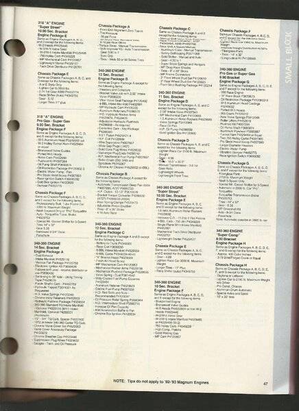

the 318 can bemade to run
Man wish I still had my old mopar performance catalog that had the setups in it. What year is that catalog?
