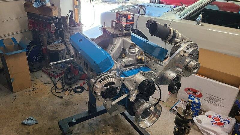

Car started overheating. Badly and quick. Something was definity wrong. Then after the new heads gaskets started seeping water into the cylinders. One cylinder on each bank. I retorqued, no change. Checked timing after putting the top end back together... damn thing won't run below 60° advance, balancer spun.
Did compression test for giggles. 155-160psi cranking on all 8 cylinders. I changed the oil since the headgaskets had seeped water. I cut open the filter and found metal. So I decided to pull the engine and fix the bearings and whatever else before it got really bad... it got bad. Lol
5 out of 8 pistons melted? Check
Broken water pump. Check
Balancer spun 30° ish check.
But... bearing looked pretty good... not sure where the metal came from. Maybe it was leftovers.
Since the pistons were screwed. Decided on a new rotating assembly with pistons that will put.me back down to about 10.5:1.
And now I get to use the electric water pump I've had for a year In a box.
And as I was going through my rocker shafts.. I found another surprise.
Glad I saw the crack.

Engine is back together. Had the heads surfaced locally, luckily they did well. Checked the deck surface and cleaned meticulously.
Added some sce titan ics copper gaskets.
Retorqued the heads after initial heat cycle and added water. No water leaks (thank god).
First drives show the car back to normal, no weird overheating or anything.
I was able to make it to the last track day of the year, this time on e85. Now I know the problems with this e85 carb. I should have it dialed by spring. Maybe earlier if I'm lucky and take it down the sea level, that would be fun.
