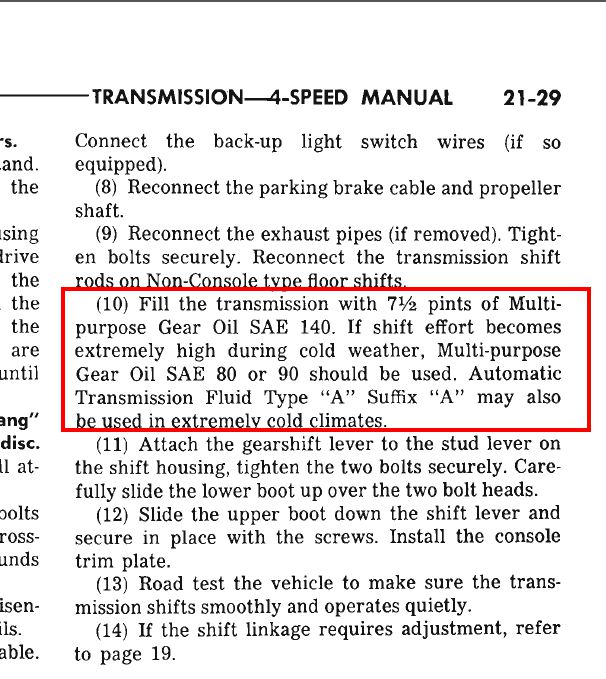

Note that Jamie Passon also recommends only GL4 90W or 140W gear oil..
For later manual transmssions besides our A-833s, maybe the synthetics may work just fine.
But I trust Brewer and Passon, they are Mopar guys for our A-833s...
Just my $0.02... :thumbsup:
