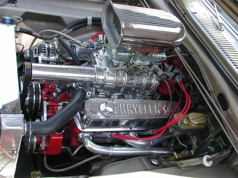

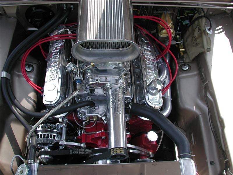

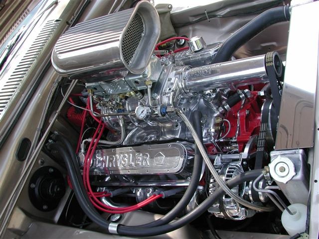

OK here are a few pics of a very nice Dart with the new early A body headers installed. I spoke with Sam at TTI he talked to the owner and they both said it was OK to post a few pics for all of us here to look at. I have all the part numbers, details, requirements etc. to do this installation.
I can tell you after talking to Sam, that it is most likely a 12 pack job, lots of patience, and go slow and follow the directions. This is kind of typical on all Early A body work though that involves the exhaust (mainly the driver’s side). There just isn’t any room as you all know!
I also told him it would be great to get some real dyno HP numbers on a few engines. Like a hot 340, a 408 and or a 416 stroker. Just to get an idea of the HP gains over the stk exhaust.
Yes they are a lof of bucks! They are built very good though, and I think those of us with much more than a mild 273 or 318 will stand to see a very good gain in performance.
I am working on a very strong 416 that is going into my 64 GT Dart. I already have a 727 that was running for about 28 years now behind the race 273. So it should be sweet ride. As soon as winter breaks in WY ( well June or so ) I will get the parts stuffed in the car and some pics of my car posted.
Well hope this helps for now... :thumbup:

It's nice to see the same Master Cylinder I'm using. It also has power steering which I will have also. Wondering if the braided hoses for the PS helps with the heat from the headers. I was going to reuse my rubber ones since they are not that old. That is a sweet Dart. Looks really clean.
Do you know if the car was a 727, 904 or A833? It would be nice to chat with this guy. Is he a FABO member?
I think it is a 727? I will have to find out for sure. Also I was very intrested in the PS as well. I want to get rid of my old vintage 64 pump and get a newer model pump. I just need to figure out what mounting brakets i will need to run the newer pump.
They still service the older style federal pumps. you can even get them rebuilt from rockauto.com and use you same brackets. If you do change they make the brackets for it or just get some off a junker.
