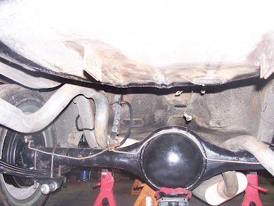

I now have the 8.75 under the dart thanks to a part crackedback sent me. Thanks Rob!

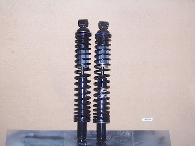

Next will be to get the new coil over shocks I picked up today on.

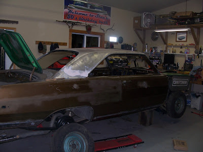

Did manage to get the 72 hood on it's been sitting outside and I wanted to get it out of the rain. So here is what the beast looks like at this time.

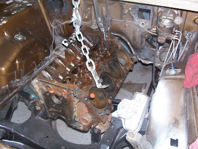

The coil over rear shocks instructions said to make sure the coils cleared the lip on the fuel tank and the exhaust. So today I put a 360 block I have in the dart.

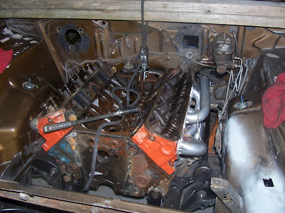

Then I set some heads we have laying around on so I could hang the headers on.
Next hooked the exhaust pipes up, installed the fuel tank and checked every thing out to see how it cleared.
All looked good, so now I can take it all back out. Then I'll tighten down the shocks and install the electric fuel pump while I have the tank out.

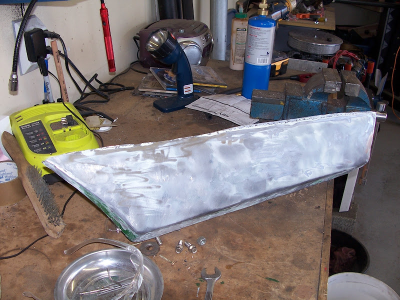

So anyway back to the repair after removing the paint and a bunch of trial fits we had it in place and ready to go.
I bought a flanger with a punch on the back side just for doing this. Thing worked great! Got it spot welded in place , but I'm going to wait for my son-in-law to come over to finish it up. He is a lot better welder then I am.

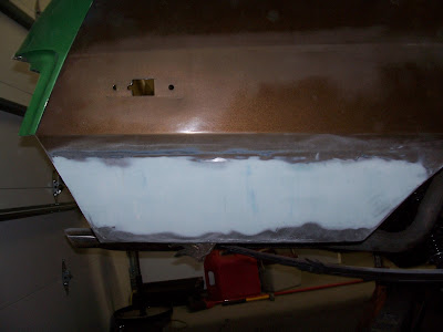

Thin coat of filler over the weld.
And finished to the point that now I'll start on the other side.

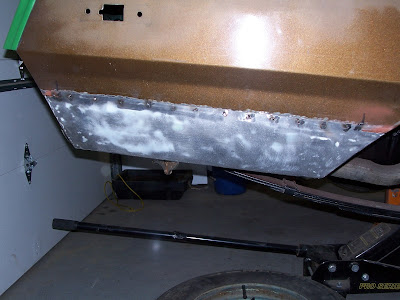

Next up was fixing the rust issue on the drivers side lower rear quarter.

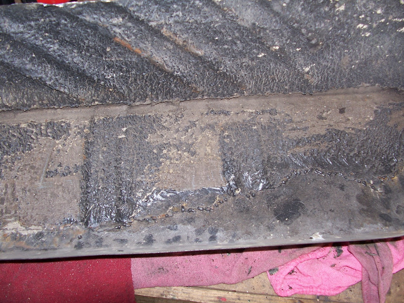

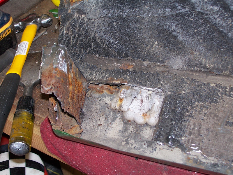

Cut the patch panel from the 72 and here is what I found on the inside.
The trunk extension was rusted off and who ever the brain was that did the body work on the 72 screwed the repair up as good as the rest of the quality work he had done on the car.
After removing the 1/2 inch of filler it reveled just how bad the patch was. I did try putting it on but am no where near satisfied with it. You can't see it in the picture but it is beat to crap and warped bad.
I'm going to order a patch panel from AMD and fix it right.
