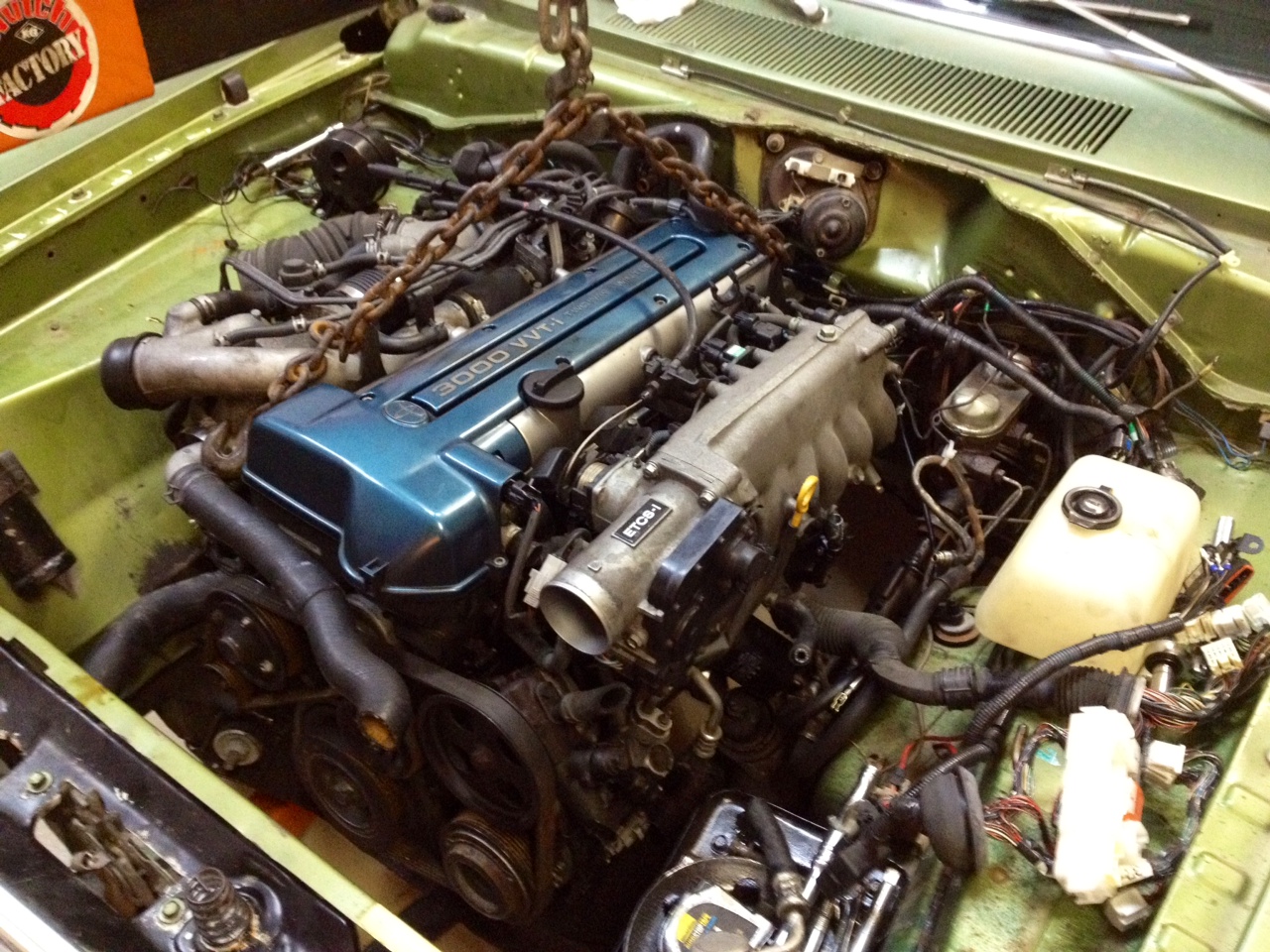

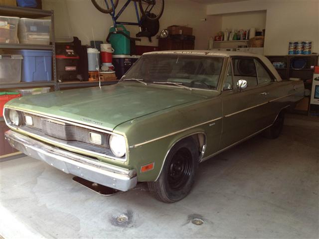

Ok I'm going to post a few teaser pictures of my 1971 Scamp Project. I know I'm going to get hate from the purists but let me explain how this little car was saved. I bought it non op from a young guy in Phoenix who literally saved it from the crusher. He spent hundreds in replacement parts and it still wouldn't run. It had been moved around the yard brutally with a fork lift. Being Original paint and all and everything there I decided to ship it home to Detroit and build a 250 day/yr driver for myself. Don't get me wrong I LOVE slants and LA engines but I figured that if I was going to drive a car everyday it better be decent on gas. A new hemi engine and trans was pricey and a pretty tight fit. I next looked at LS engines but didn't have the heart for that. A turbo ecotec passed my mind but not enough torque.

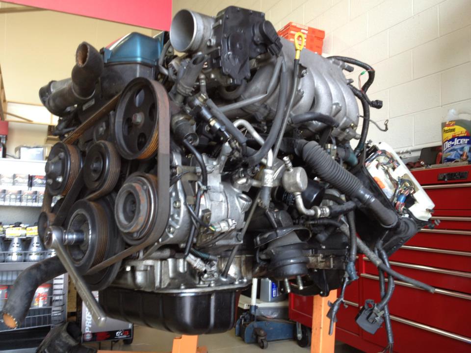

So I decided on a JDM, (Japanese Domestic Market) Toyota twin turbo inline six, with Variable Valve Timing and a good 4 speed automatic transmission. Anyone who has built other cars will tell you that 7 main bearings and a German designed 4 valve head gives this engine fantastic potential. In stock configuration with bolt ons this engine can easily put 500 WHP to the tire. Fuel economy could be close to 25 on the freeway.
So far I've yanked the dead slant and tossed the Toyota engine into the bay to see what needs hacking/welding/shoehorning to make fit!

OP: Could you get some detailed pics of how it mounts/oil pan/ how low it sits?
Those 2JZ's are pretty tall engine i believe. And kudos for doing this, it was on my mind about a yr ago when my friend was temporarily storing a 2jz and some other honda motor for his neighboring import shop. I love the way those turbo 6's sound.

My initial thought was I'm going to build this with an AlterKation K member, 1.2 FT Brake Rotors, and just keep going until its stupid. Then my practical nature set in. I want to eventually promote my company's (Fram/Prestone/Autolite), brands at events like Street Machine Nats, Powertour with a bright orange custom Mopar that any car crafter could build and have it be a reasonable, fairly practical piece that allows for an upgrade path down the road. I'm going to try and build a car with air conditioning, power steering, and brakes as that's the hardest version to work around. BTW, Please like "Autolite Spark Plugs" on Facebook if you have time and help support the project there so I get love from my team!

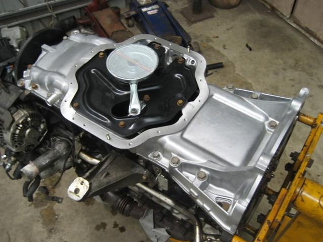

So far here's what I know:
1) You obviously will need a JDM take out engine and trans.
2) An Australian, UK or UAE oil pan with a true MID SUMP OIL PAN from a mid 90's Toyota Crown, 2JZGE. ~$600 used. You can have Stef's make you a custom pan for $900 so don't worry too much if you can't get a crown pan.
Here's a Crown Pan:
Now, you could notch the heck out of the K Member for the JDM Aristo front sump oil pans but I'd say forget that because the notch will mod the K Member SO MUCH that you might as well call Hemi Denny and start fresh.
3) Remote Oil Filter Mount to clear power steering gear box.
4) Of course custom mounts. The Toyota biscuit mounts are beautiful and beefy but sadly wont clear the chassis.
This is not a small engine, not a light engine, not a simple engine. As long as you keep your arms around that fact then I suggest going forward. If I have TRUE interest from others I will copy a set of mounts and sell a set to defray some of my build costs.
