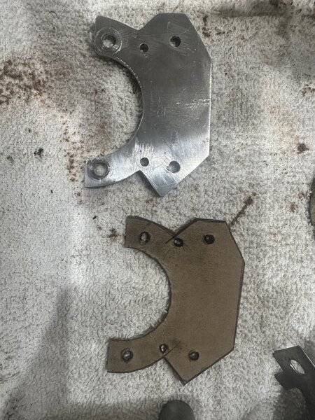

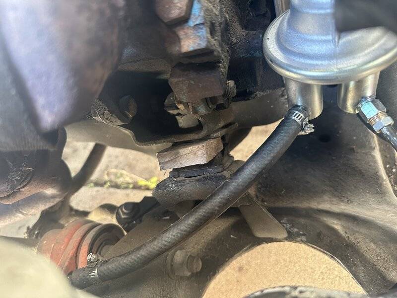

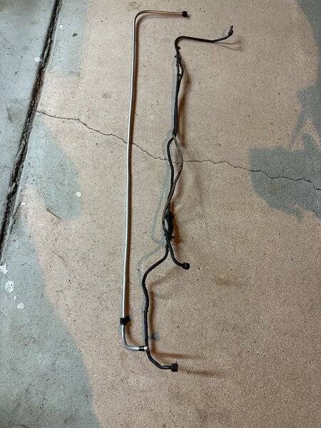

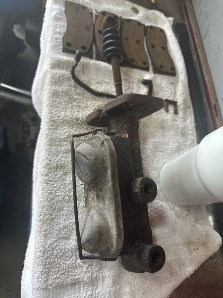

Ive worked on the car quite a bit as of late. Got it off the trailer once I freed up the brakes, found out they were stuck because the PO put Kelsey Hayes disks on it but left the original drum master which still had residual pressure valves in both ports. I had previously ordered new calipers, rotors, and pads but when I was switching over the crossover tubes from old calipers to new, rust happened and I snapped one. Off to summits website and I ordered a stainless like kit with all 4 hard lines. Also placed an order at Dr. Diff for an aluminum 15/16” master and adapter kit. Now just waiting on parts. I also pulled the radiator and started cleaning up some wiring in the engine compartment, to begin putting the front of the 318 back together. That’ll happen this week after work if I get some free time.

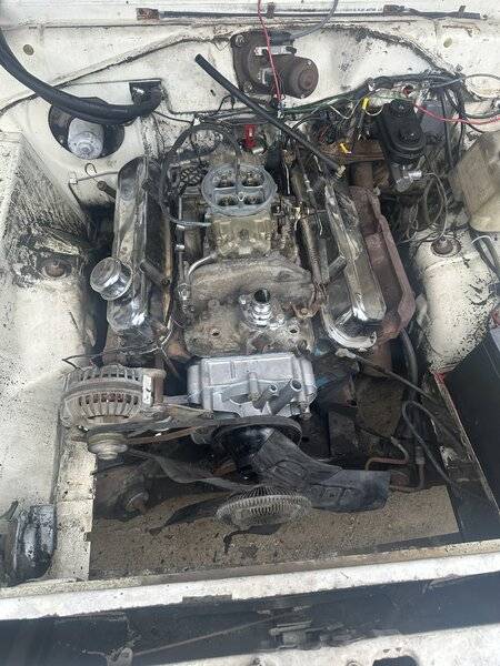

I’m slackin on the updates, sorry fellas. I don’t get much time during the week to work on the car and last weekend I was out of town for a few days, but I have fiddled with it a bit. I cut the 2 barrel throttle cable bracket in half and moved the cable mount around, lengthened the throttle pressure rod, went to Bob Mazzolini racing and got a Holley, mopar throttle lever, took off the 650avs2 and stuck on an old 3310 (I’m a Holley guy) I had. All of the carb/kickdown linkage works perfectly now and it has full throttle. The master cylinder and adapter came in from Dr Diff so I crawled under the dash and got that all installed. Kelsey Hayes line kit came in so the new calipers are ready to go back on. Called up a friend and he weaseled me a comp xe268 that he had sittin on the shelf (unobtainium of you ask Comp, no cores) I got lucky there. That’s as far as I’ve got. No pics but I’ll snap some tomorrow after work when I get a chance to work on it again. I’ll probably start on the cam swap and front dress tomorrow.

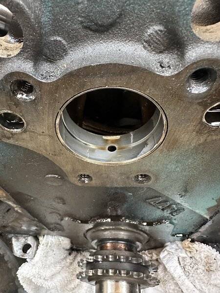

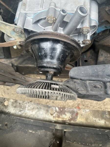

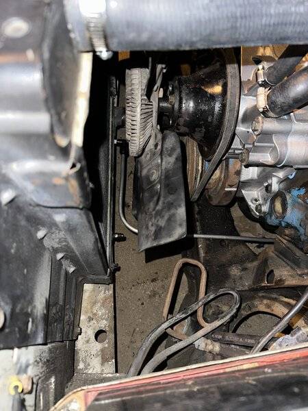

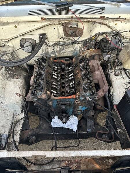

Had some time over the weekend and Monday night to work on the dart. Tore down the top half of the engine for gaskets (looks like the last guy had way, way too much faith in orange silicone) and a cam change. New timing cover and water pump. Forgot to put the oil slinger on and the balancer hit the cover so I actually had to do it all twice. Had a bunch of trouble with the fan clutch and pulley alignment but got that figured out as well. I’m certain the fan and clutch that came with the car were never on this engine. Had to drill out the bolt holes in the fan clutch. But I got it all put back together. Fixed a bunch of engine compartment wiring and tested the ignition system to make sure this thing will light right off to break in the cam. Last night I tore out the old (and in horrible shape) trans cooler lines and started making new, got one finished and installed but have one more to do before I can fire it.

Yea it does run and drive now. But that brings a whole host of other new things to fix. The cam break in went well besides the temp creeping up a bit and having to shut it off twice. Not sure I trust the radiator that’s in it just yet, the whole system had a bunch of rust in it and the fan clutch is pretty loose. But the little teen runs fairly well. It smoked quite a bit in the first few minutes but really cleared up after running a while. Got all the front brakes back together and (almost) working like they’re supposed to. I made @Turbo440Dart reluctantly rob some hardware off my yellow car that was missing from these calipers just to get it going. Still have some air in the system to bleed out, but they do stop the car after a pump or two. Transmission seems to shift pretty well but too fast, I think it was in 3rd at about 16mph. Now the bad, the exhaust system is absolutely terrible, driving down the road it sounds like I have a trunk full of angry children trying to hammer their way out. Quick look shows the driver side is attached only to hopes and dreams. Burnouts in the dirt showed the passenger side engine mount has left the chat as well. But it’s running, movable and kind of drivable so that’s progress right?

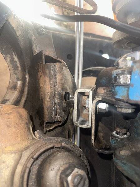

Spent all day Sunday dealing with engine and trans mounts. All of the mounts on this car seem original and in absolutely terrible shape. The driver side engine mount was basically just two plates with no rubber. The passenger side still had rubber but wasn’t bonded any more. And the trans mount had been in the relaxed, lazy position it was in for so long I couldn’t pull the engine forward to make it live where it was supposed to. @Turbo440Dart gave me one solid mount so I put that in on the driver side and had to make a “custom” temporary passenger side mount to keep the engine up while I wait for parts. I also had a brake line that I reused on the driver side caliper that didn’t leak until pressure was put to it so off came the brakes again for another new hardline.

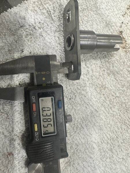

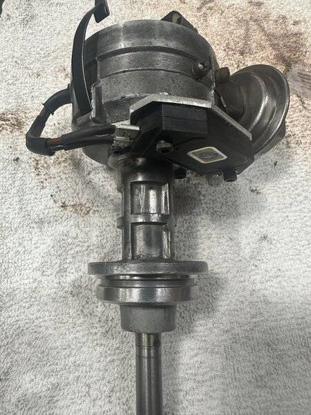

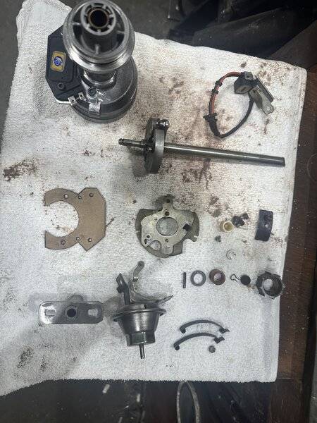

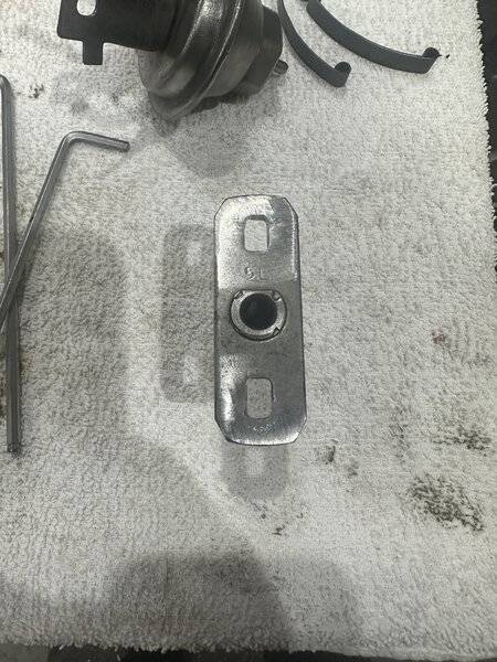

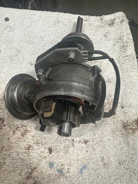

Been fighting the points distributor for the last few days. It’s been misfiring quite a bit all throughout the rpm range so I cleaned the cap, rotor, and points on Saturday and magically the engine wouldn’t run anymore. Pulled the distributor, cleaned the rubbing block and points of all old dried up grease, re set the points and lubed everything back up and it ran again. But that made me want to upgrade it moving forward. So here we are. Dug an old electronic distributor out of my stash, tested the pickup and vacuum can (both work perfect) and got to work. I disassembled and cleaned the entire thing, welded up and filed the slots to .385, got rid of the long loop heavy spring and add a light spring, so one medium and one light. Made a template and cut some 3/16” aluminum plate for a bracket and mounted an hei module to the bottom of it. Instant, cheap, reliable electronic ignition. I will use a spare e core coil from a magnum dodge truck I have in a box somewhere I just haven’t got that far yet. Might try to install it tonight and do some wiring on the car side.
First test. The pick up coil wasn’t square to the reluctor, had to bend the tab slightly to line em up. After I fixed that the spark was much more consistent and strong.
