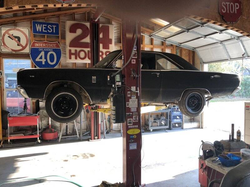

Car lift, yes.
Torches? No....I'll weld this with the MIG.
