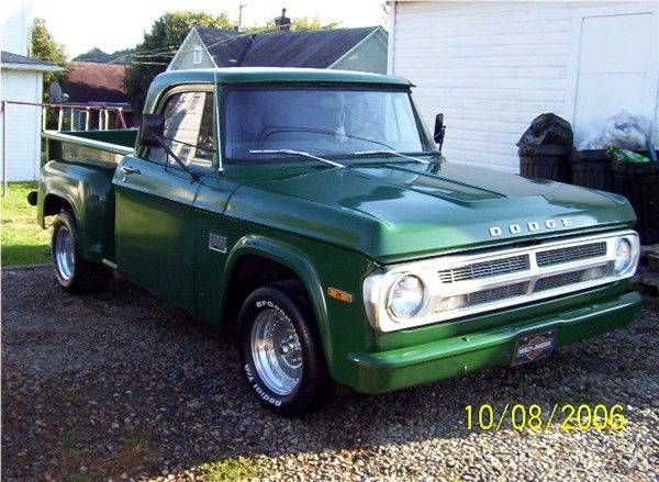

I made the mistake of painting this truck with Ace hardware oil based paint, the same stuff as Rustolem, yes it looked good, but every month you had to wax it, to keep it from turning chalky.

Unfortunately I wrecked it one day on the interstate, hit black ice and put it nose first into the guardrail at 40 mph.
Well that sucks. Did you clear coat that truck? The side doesn't look very shiny. If you didn't, that could be one reason why it was trying to get chalky.
No clear, just straight out of the gun.

No clear needed.
