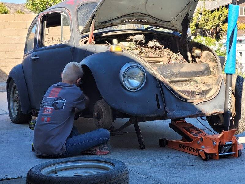

He's pretty excited about building it. He's got a plan and the drive to get it done. Now I'm not going to let his build hijack my thread but here is a few more pictures of him with the car this weekend.
