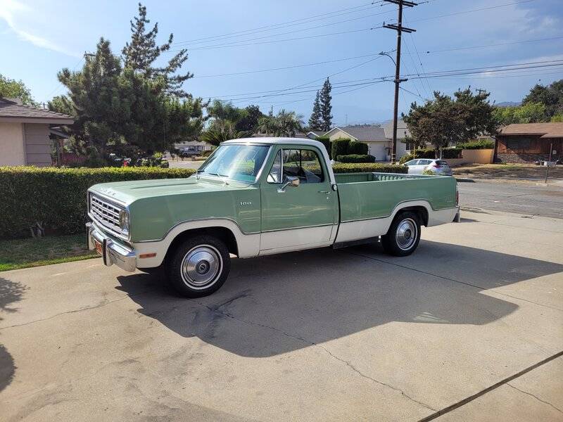

So I did a thing...
Got side tracked and this followed me home..
It's a 1973 D100 Adventure 318 w/ 3-on-the tree. In perfect condition. Purrs like a kitten... and fun to drive.
That's a nice truck! I've been saying I need a 3 on the tree in my life for a while now! I better find me one!
Cley
Going to Hemi swap it?
No this one is just too minty Fresh. I'll of course put an exhaust on it.. But no I'm looking to keep this one stock..
1973 was the year of my first truck, but it was a D200 camper special with a 360/727. Nice truck!
I had a that same truck but my was a 74 D200 360/727 Loved it. its the reason I bought this 73 D100 I missed it soo.
74 D200 360/727
73 D100 318/A230 3nTree
