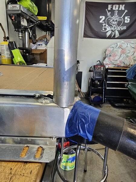

Planning on test starting the car this weekend but didn't want to run the 545rfe dry. So I had to get the radiator modified and trans lines built. Big mod I had to do was to change the top water inlet size from 1.25" to 1.75" I believe I mentioned it in a earlier post that I saved about 2-3 hundred dollars on a griffin radiator by buying an LS swap radiator vs. The hemi swap radiator. Only difference was the top inlet size. The following pictures are the mod needed.
It does look nice. I’d make that bend out of 1-3/4 aluminum tube in a heartbeat.
