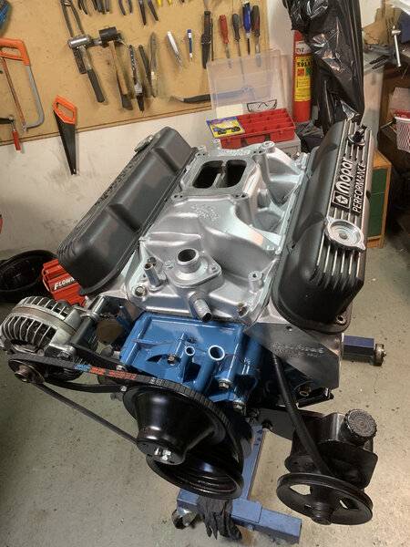

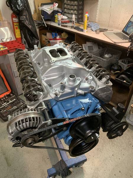

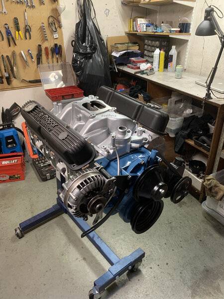

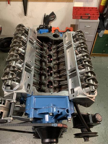

I test fitted the intake with gaskets and the valve covers. They cleared the intake no problem. So I JB welded the gasket mating surfaces on the covers. When it's cured I will sand it straight and smooth. Next step is to install lifters, pushrods and the rockers.
Because of work progress has slowed down a bit. But today I installed the engine mounts from Schumacher and cleaned and some parts.
Some more progress. Will install the intake next. It's really heavy to rotate the engine now with a normal ratchet.

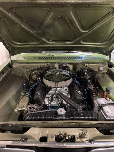

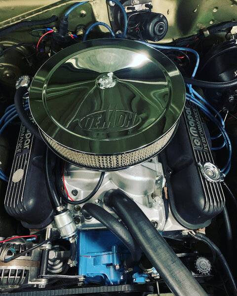

It's been a while since I posted. But much has been done in this time. The engine is in the car and the break in process done.
It's mostly together now. I so badly want to drive it, but there is just too much ice and snow on the roads here still. Also, me and everybody else that I share this shop with, 29 cars, have to move out before the end of March. We have a new place that is going to need a lot of work, but has great potential. Looking forward to the spring!

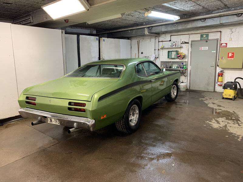

First wash in a very long time. I also took it for a first drive around the block today. Man, that felt good after all this time. To be honest it has been nerve-racking every time I have started it up with the 360, just because I put it together myself, something I have never done before. But it sounds really happy and very responsive. I took it very, very slow today. I had never driven it with the new Wilwood front disc brakes. First impressions, engine felt great. Brakes not as great. The pedal is firm, but I feels like I have no power brakes. I used the stock master cylinder, and I don't have a proportion valve. I suspect I need to get another master cylinder and a proportioning valve. Any ideas? I want this car safe and running so bad now :)
Or could it be that the XE268H - Xtreme Energy cam produce to little vacuum? If the weather is ok tomorrow I will do some driving around the block and try the brakes. Also gonna measure the vaccum.

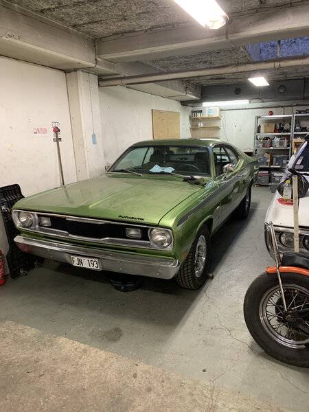

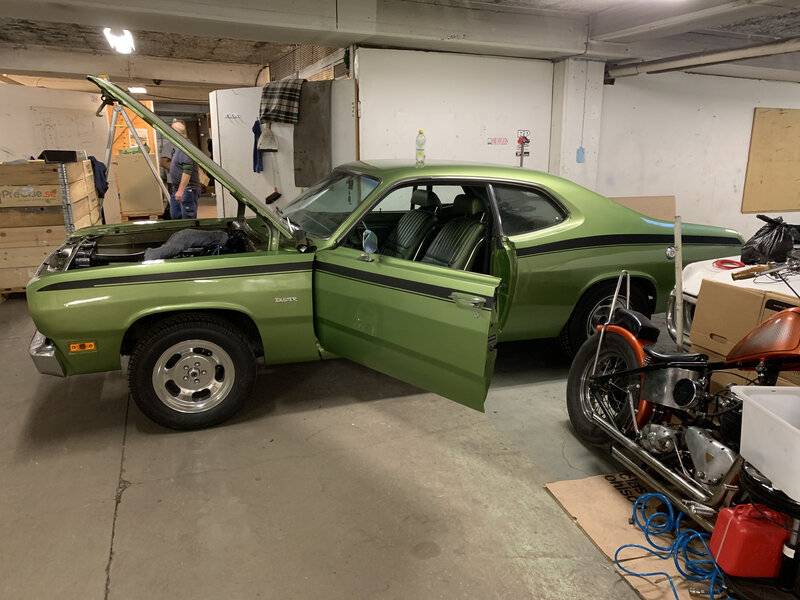

Today we moved the Duster to the new garage. Looking forward to getting it road ready!
