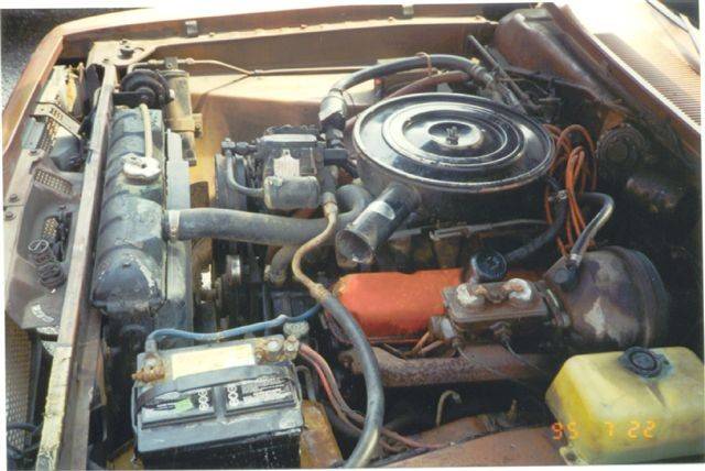

In this picture the firewall is original paint, and I had to respray the entire drivers side inner fender because of battery acid eating the paint. I touched up the passenger side as well. I just moved wires out of the way and masked off the rest. The second picture is what the engine bay looked like when I bought the car.

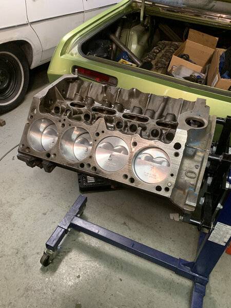

Cleaned the block for the second time today, and also the crank. Will be installing freeze plugs, oil galley plugs and the crank asap.

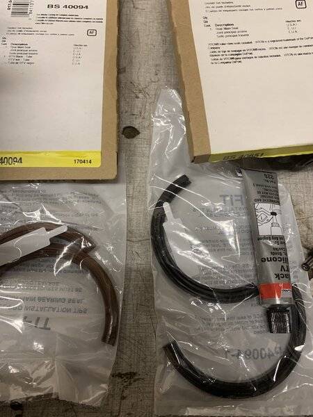

I seem to have 2 versions of the rear main seal. Is one better than the other?
