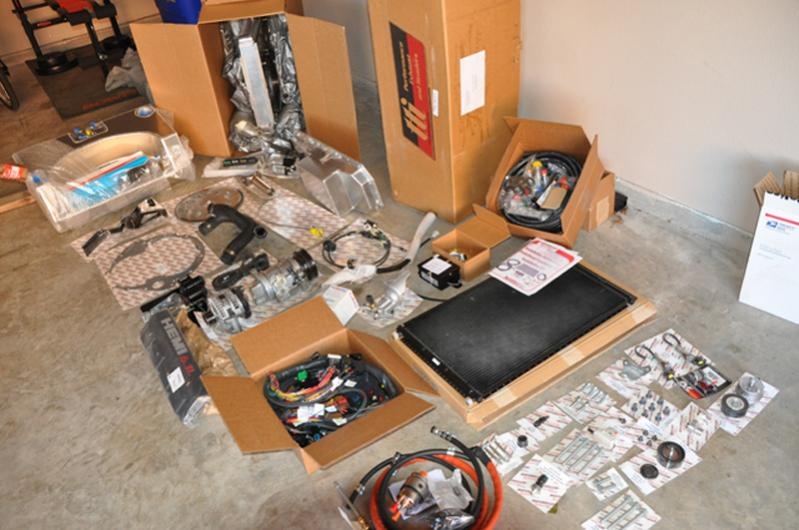

So I am still working on the trunk before I take pictures of the electric latch but it is almost done so stand by for those. Here is the pictures of the A/C unit that I had to search for to find the proper size unit. Thanks to everyone who took back the units that did not fit.
Getting real close to being ready to go to the paint booth. I better decide the color scheme real quick.
I am thinking blue and Graphite, but not sure where what color is going quit yet, but I do have some wild ideas..
Stand by for that..
Forgive the large bolt on the bottom I needed another short bolt, but wanted to see if it fit right now
