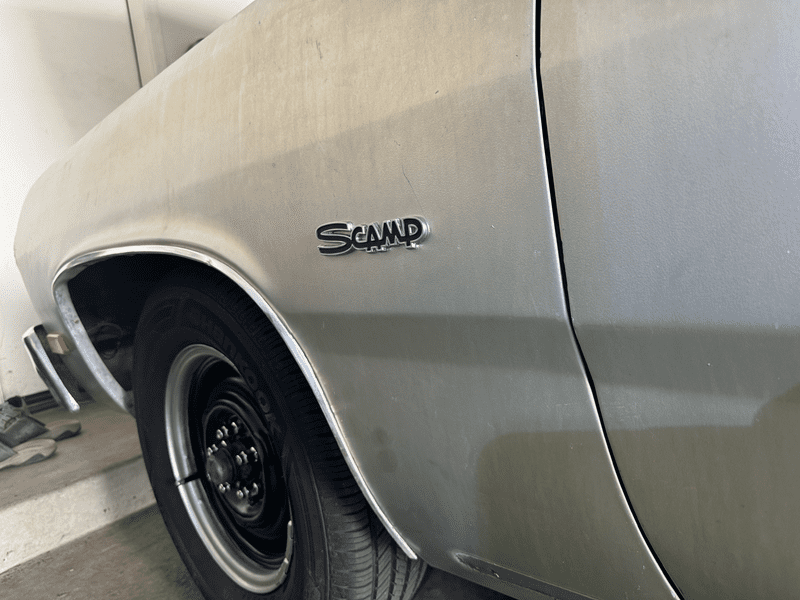

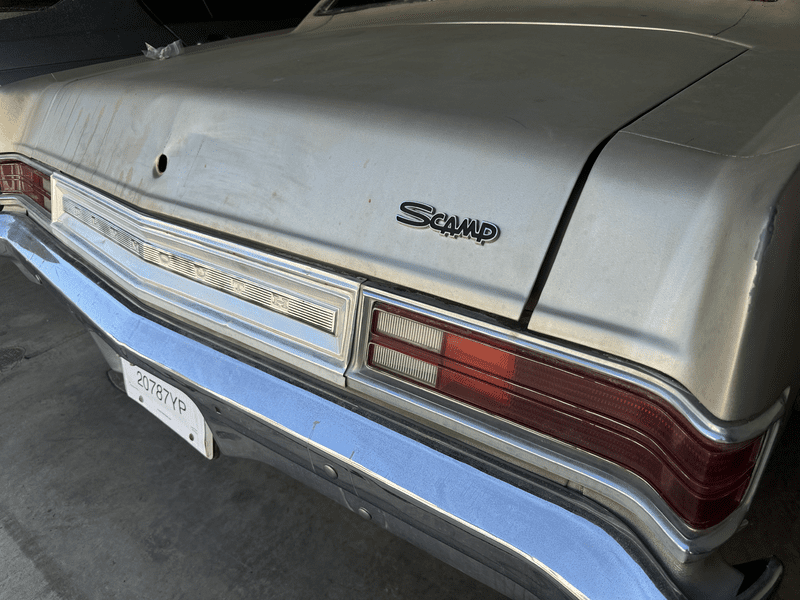

I got barrel clips in for the emblems...

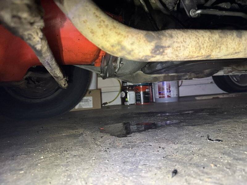

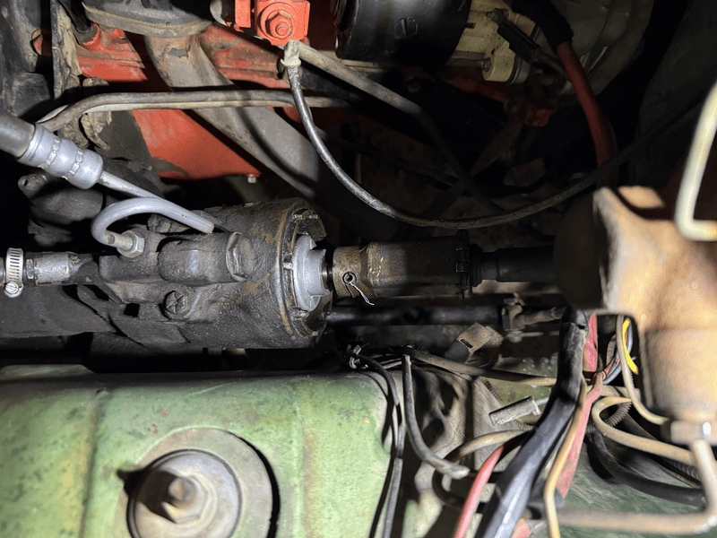

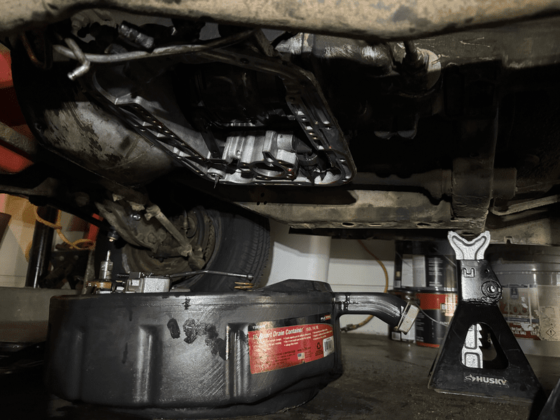

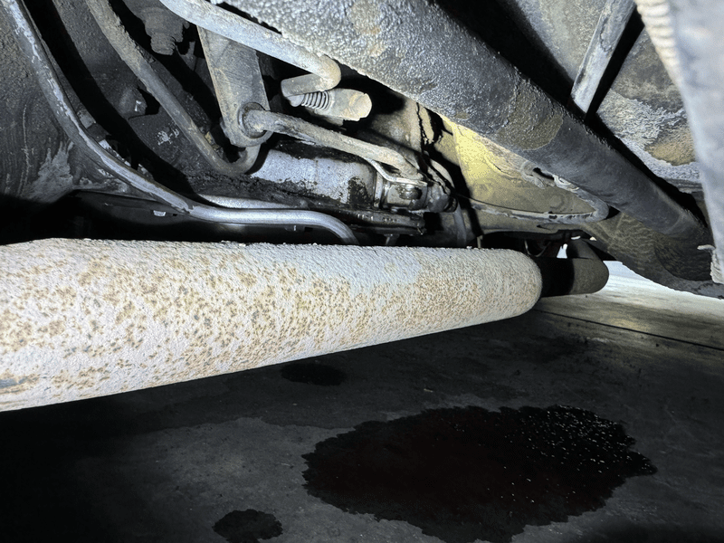

And I found a small puddle of trans fluid under the car after the most recent drive. I cleaned things up so I could figure out where it was coming from. Then I added a little trans fluid and found a new puddle...

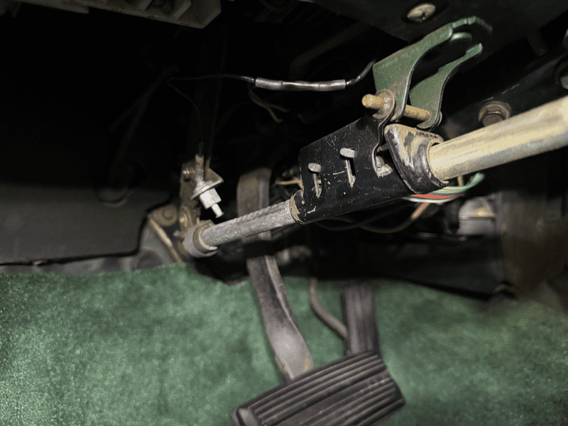

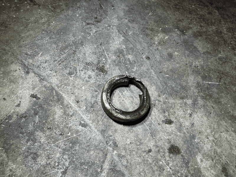

It looks like the shift selector shaft seal is garbage. New seal incoming. Oh, and another seal for the PS input shaft. I thought I had straightened it out good enough, but it's leaking already.

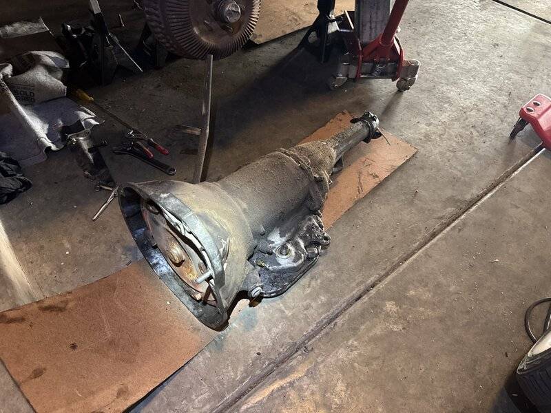

So, about the trans fluid leaks, I knew the selector shaft seal was bad, but I also discovered leaking at the tail shaft, so I pulled that seal and ordered a new one.

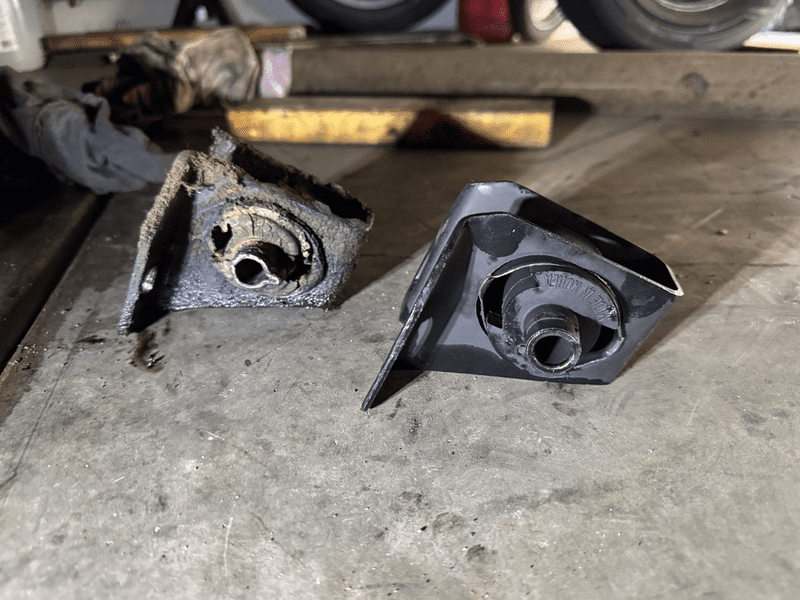

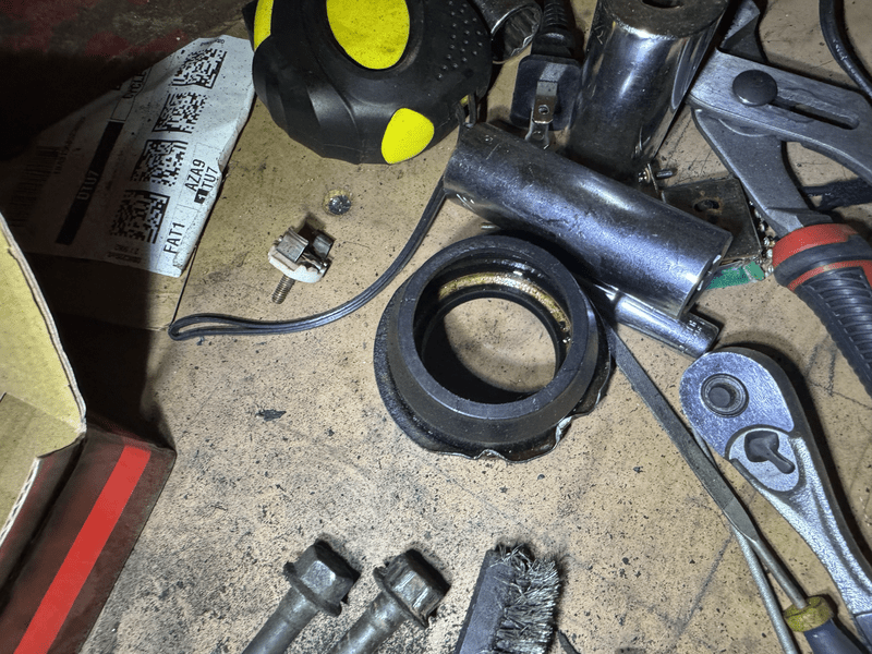

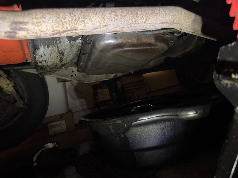

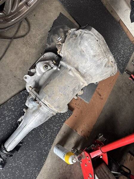

Then I attacked the shift selector seal. When I realized how tight it was under the car, I decided to pull the crossmember and lower the transmission a bit. That's when I remembered that in the box of parts that came with the car was a transmission mount.
I bought the tool that is supposed to make removing the shaft seal easy, but it didn't. I finally decided to cut my loses and drop the pan again, and remove the valve body. I had the seal out 2 minutes later.
