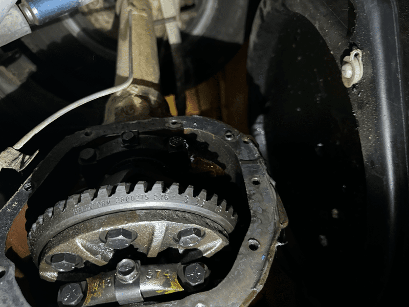

This morning, I decided I was going to open the differential to change fluid and visual inspect, so I bought a new gasket and gear oil on Amazon, which arrived before I got home from work. I had seen a small spot under the differential like it had a minor leak. When I pulled the cover, I realized the previous owner had removed the cover at some point, smothered it with gasket maker, but didn't use a gasket. I believe I'm reading the ring gear stamp correctly that I've got 2.76 gears.

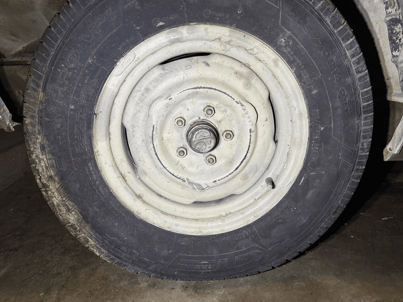

This weekend, I plan to drive an hour out of town to buy 2 14" 5x4.5 stock steel wheels for the rear. I'll get 4 new tires next week. I did put the Cragars back on the rear so I can drive to the gas station around the corner to fill up. I absolutely hate the way they go on the car with the elongated slots and offset washers to align them. The next time the wheels come off the car will be the last time.

Yup. That's a 2.76 alright. Great for cruising!
Big day!
After cleaning up the rear end cover, installing a fresh gasket and refilling with gear oil, I made it approximately 1.2 miles round trip to the gas station.

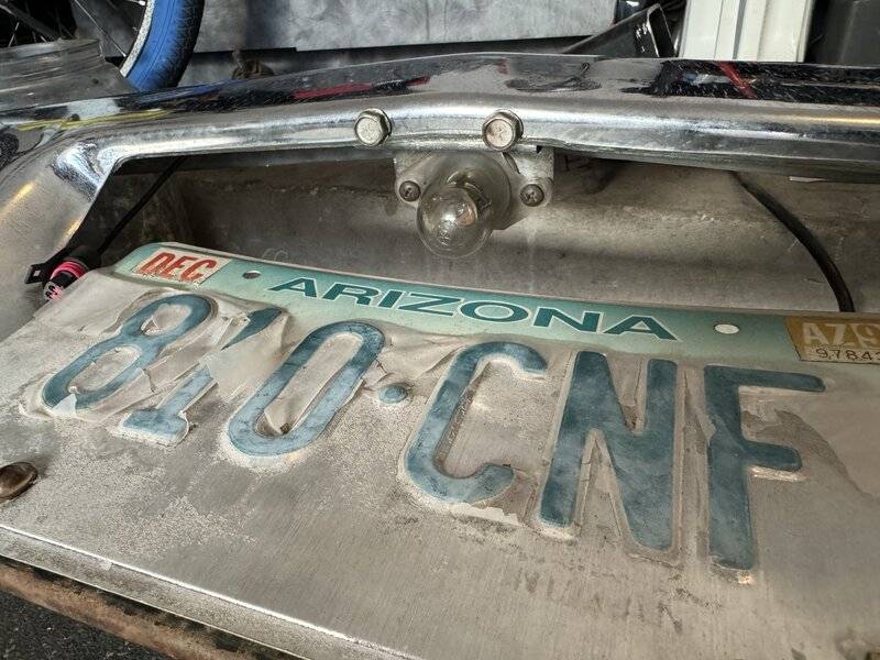

Yesterday at the salvage yard, I grabbed an oil dipstick tube and dipstick from some random Mopar, and a license plate light with bracket from some random Mopar truck with a steel bumper. Today, I fitted the dipstick with the addition of a small bracket extension.

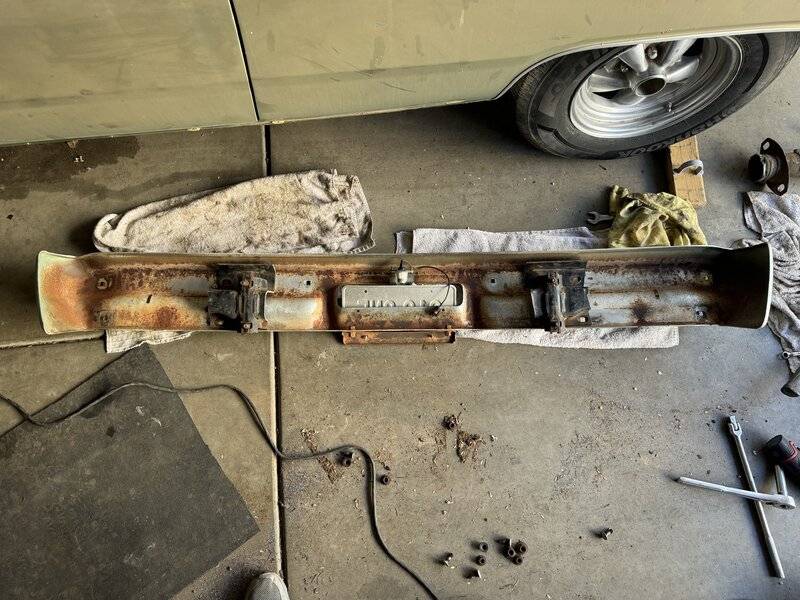

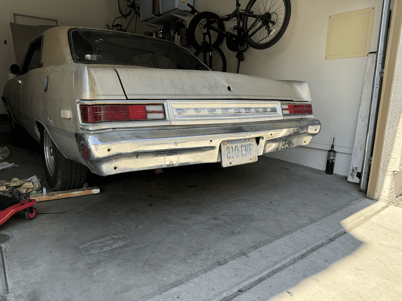

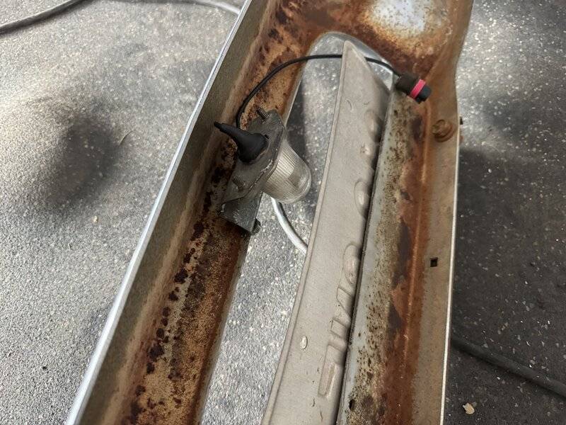

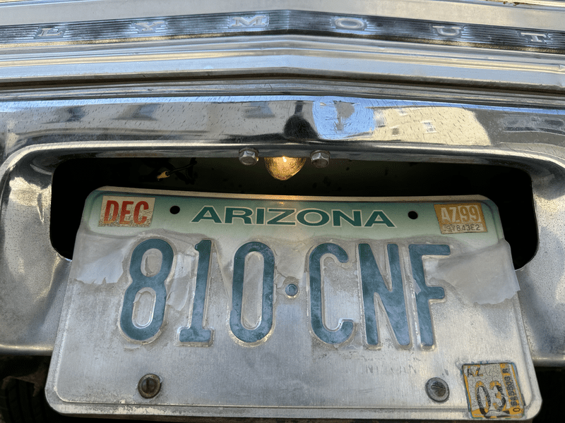

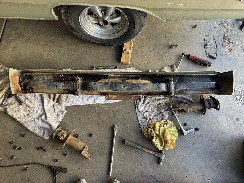

It’s been on my list for awhile to remove the rear bumper and cut that massive bracket down. I figured I could tackle that and fitting my new license plate light. The light bracket needed to be cut down a little, and bent significantly to make it work, but it looks pretty good off the car right now.

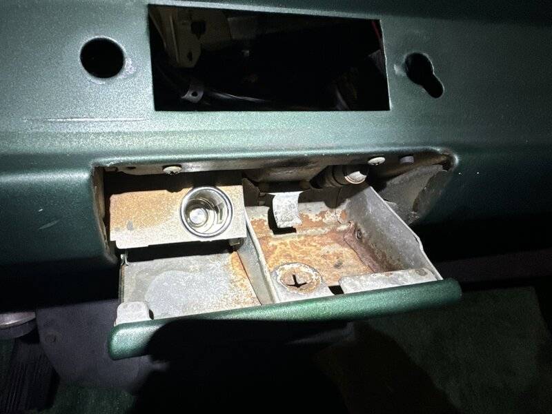

I had cleaned the trunk light switch and socket a few days ago. New 1004 lamps arrived today, so installed the lamp and reattached the socket. It works great!
I’m jealous, courtesy lights and switches have been on my list to work on for a while, nice to see the original switches worked!

The rear bumper is back on, and the license plate light worked out grea. The only change I might make is switching to stainless steel bolts with a lower profile. No biggie though.

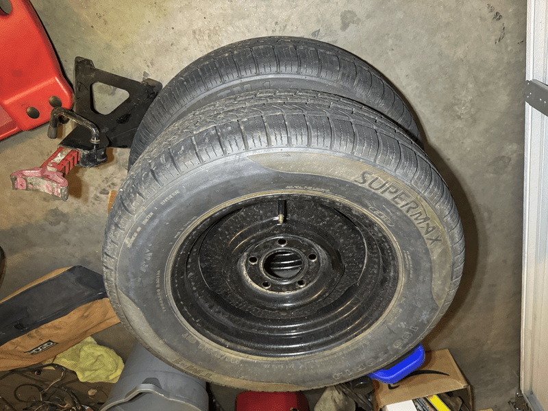

I picked up two 14" 5x4.5" steel wheels for the rear yesterday after a 75 minute drive out of town. I took my kid with me and we stopped for lunch on the way back, which was nice, but traffic back into town was awful. Oh well.

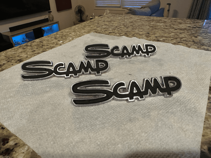

I then cleaned up the Scamp emblems that were collecting dirt and dust in the glove box and had my kid repaint them.

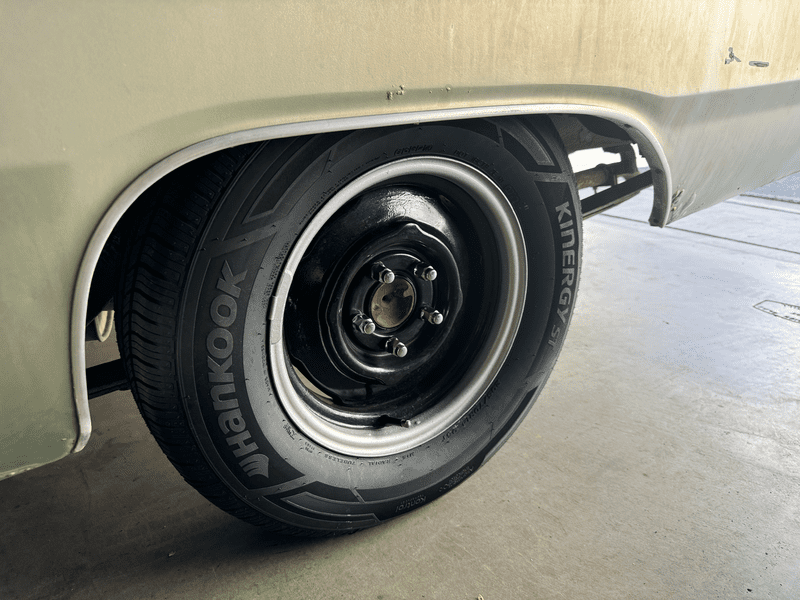

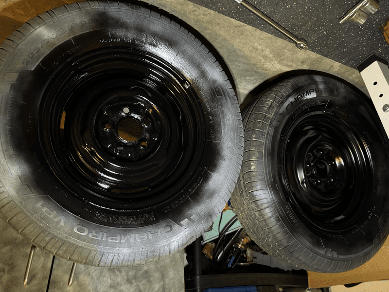

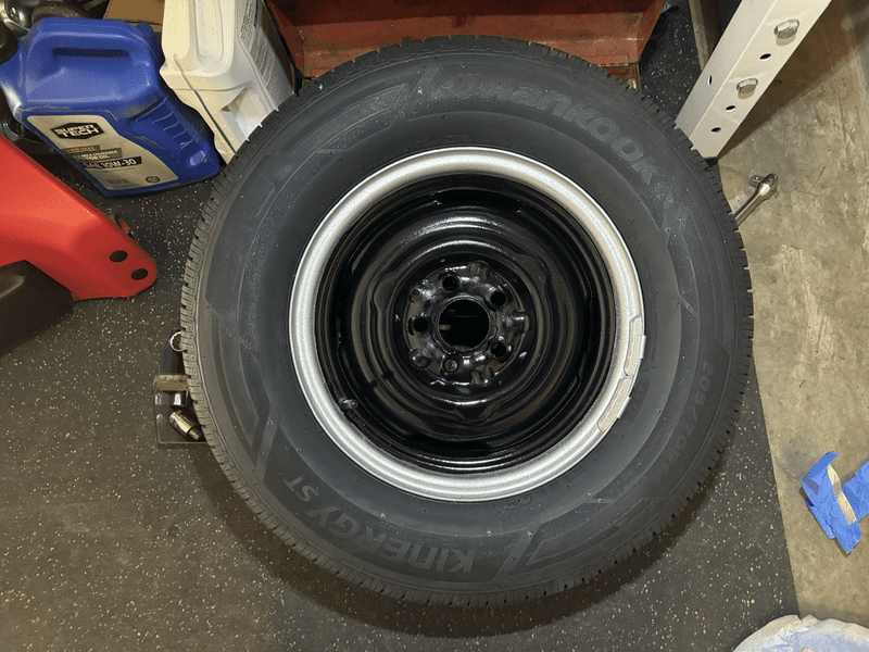

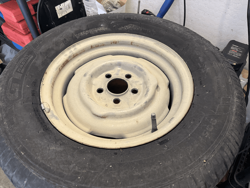

After picking up steel wheels for the rear to match the ones I already had in front, I decided to paint the wheels black and paint a sliver trim "ring". I don't think this is going to be popular with everyone, but I like it, and the price was right. I had a '94 Caprice 9C1 years ago and gave it the same treatment. Anyway, I went from this...
to this...

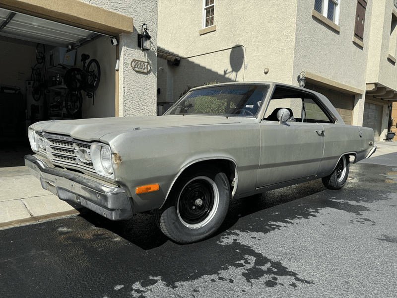

I half-*** washed the car, and some of the gold respray came off. Here's what it looks like now...
I've got a significant transmission fluid leak. I cleaned things up under there and I think (hope) it's the pan gasket. I'll swap it out tomorrow.
I took another short drive this morning. Everything worked, the car ran great. I have an AZ Level II inspection scheduled for next week so I can get the Dismantled Title reassigned and finally register and plate this thing.

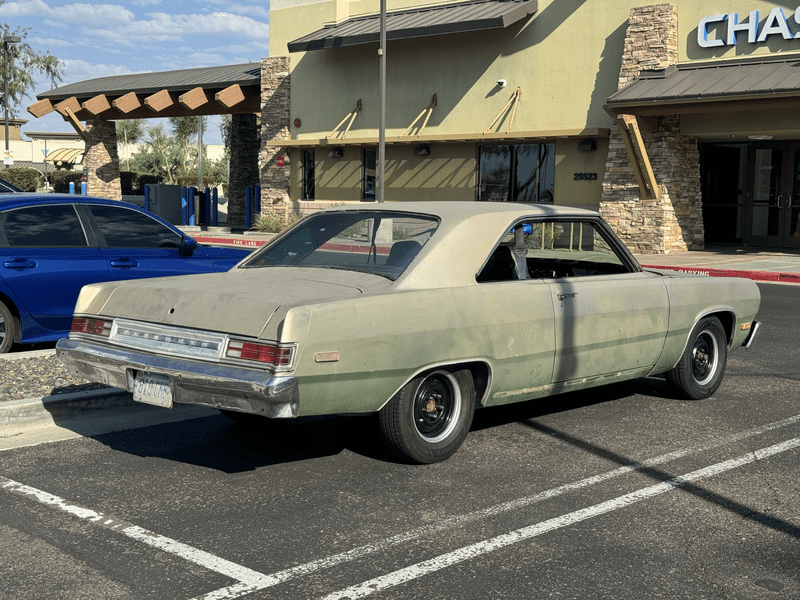

Believe it or not, I always wanted a green Scamp.

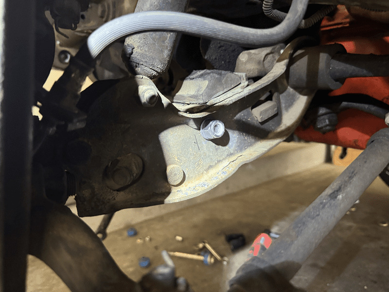

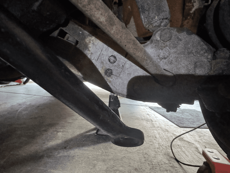

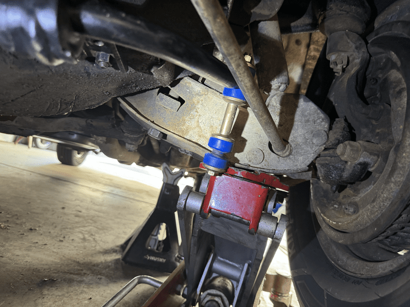

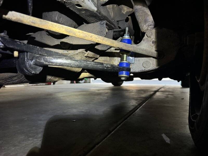

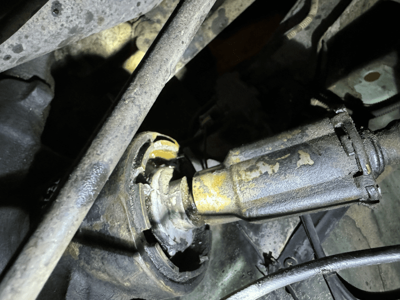

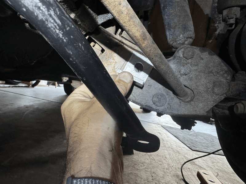

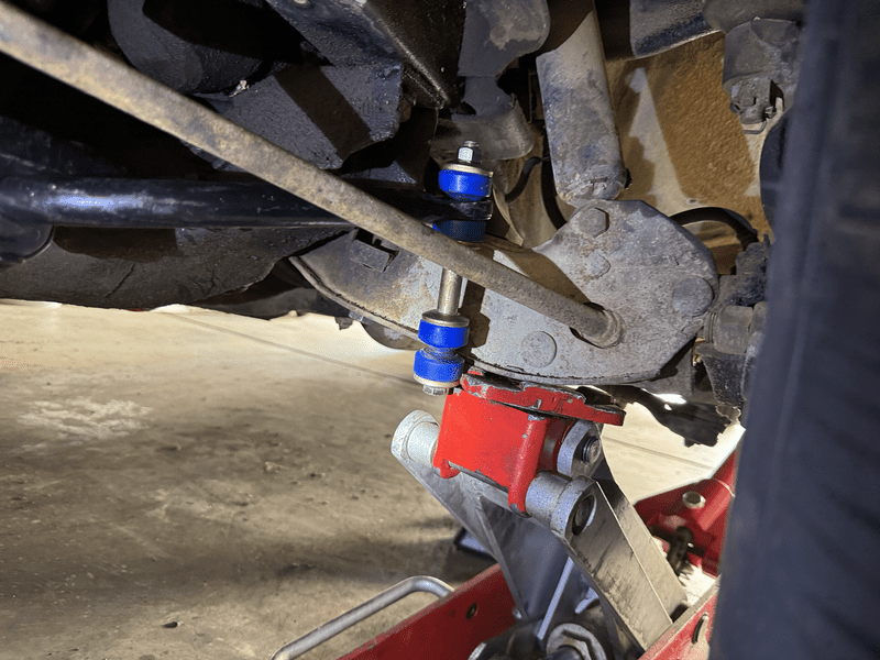

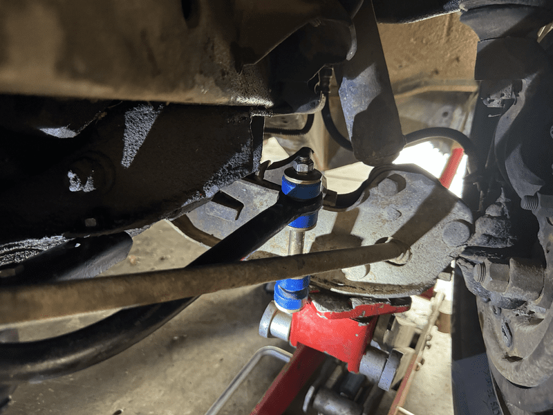

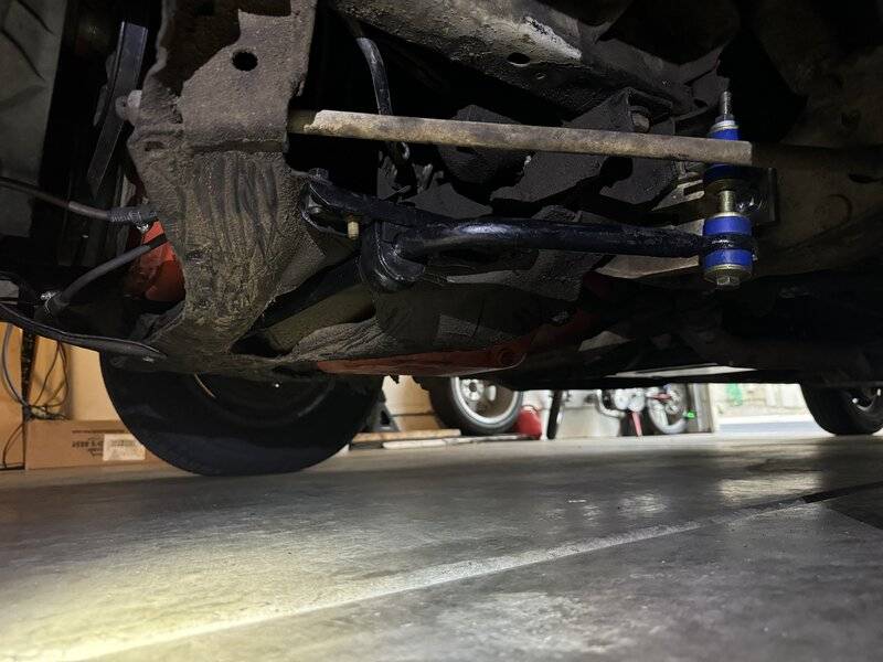

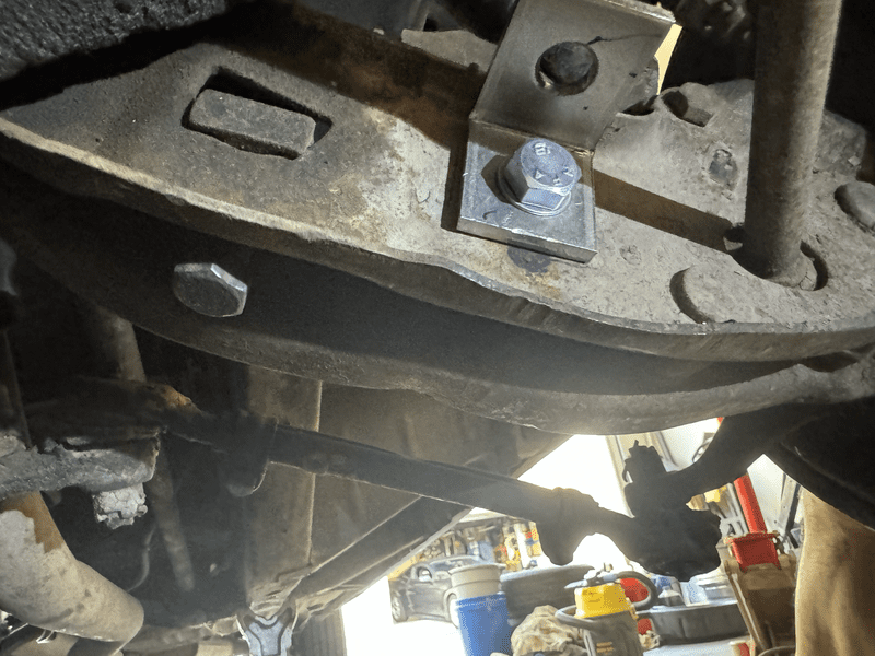

Sunday, I tore open the box to the new-to-me stock sway bar I bought from a member on this forum. I crawled underneath and scraped and brushed dirt and grime for 30 minutes before figuring out the orientation of the brackets and bar and got them installed. My LCA's do not have the sway bar tab from the factory, so I'll be working that out soon. I took the end links out for now and wired the sway bar up so it can't drag down while I sort out completing the install.

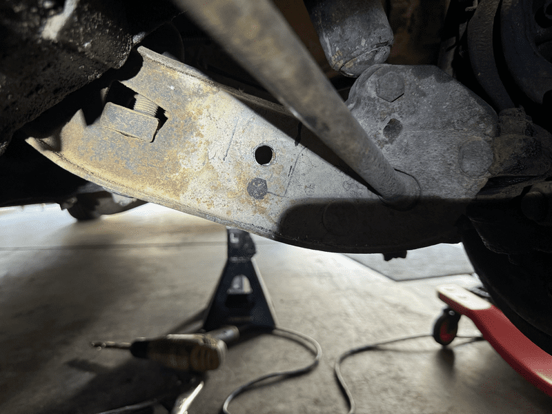

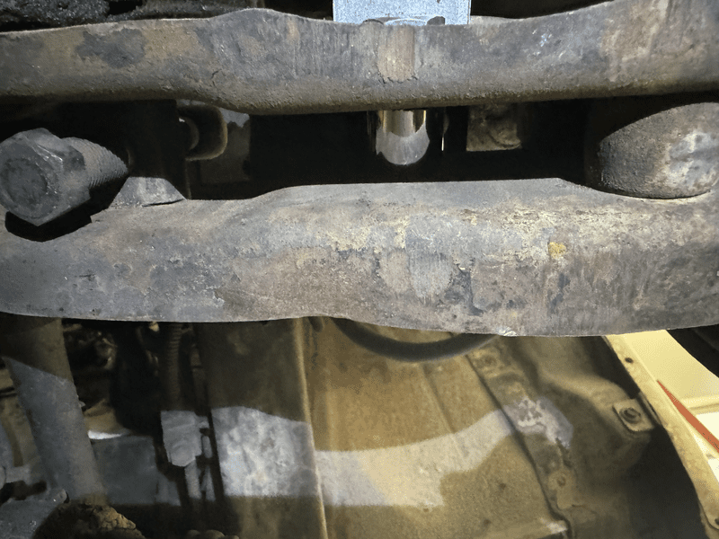

My first idea was to add an angle bracket to the bottom of the LCA and mount the sway bar above. After researching more here, looking at the Hellwig instructions for their bar, and watching several videos, this seemed like a better approach for my stock '73-'76 sway bar...
I drilled all the way through the LCA. Technically, I drilled from the front, then from the back. Then I cut a sleeve for the inside of the LCA out of some scrap steel tube I had laying around...
Then I bolted it all together...
I'll repeat on the other side tonight. My end links seem a little long, so I'm going to cut the sleeve down a little so the sway bar doesn't hang too low. Hopefully, I won't need new bolts, but that'll be pretty easy to solve if I need to.

looks like you'll need longer bolts, they don't reach the nyloc part of the nut. good idea bolting right through the lca and using a sleeve, that'll stiffen the lca too.
neil.
Good eye! The photo was taken before I torqued it down, but I'll double check and make sure it's into the nylon, or I'll be getting new bolts.

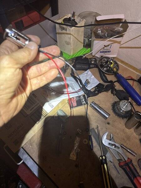

In the meantime, I’m working on something…
(…it’s a killswitch)
