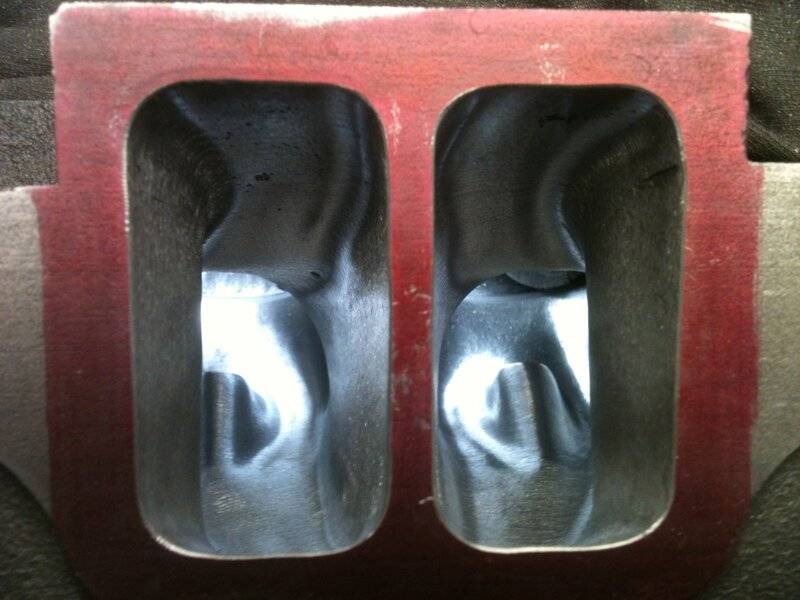

I wish I had my old flow sheets still but I know stock 440source heads flowed around 267cfm max. Now you stuck the word good stock heads so I can’t say you are right or wrong because maxed out big block heads can be made to flow in the 300cfm area in the right hands. Some do, most don’t. I never really played with stock heads but have a set of stock ported heads that ran 9.82 back on the 1980’s in my 74 duster. So it can be done but I know how easy 440source heads jump up to 305cfm because I did it easily way before I knew what I know now. What would really be a nice addition to this post would be flow numbers from .300-.550 with both heads. That would tell the whole story. I can’t help with that but we have a couple of members that could. Step on in guys. The waters warm.
Stealth heads with the seats recut and a nice bowl blend with flow right about [email protected] lift.
Most home ported stock heads(especially 906’s and 915’s) I’ve tested are typically in the 250 and less range.
The [email protected] is a little more than these flowed:
On my bench an ootb TF240 flows right about 316/[email protected], and 320/[email protected] lift.
I’ve tested about a dozen of them, they’ve all been within a few cfm.

PRH gave a great example of the stealth heads I just did. The valves were sticking out off of the seat. It was close to .080 that I ground to get the seats correct but other than that the spring installed heights were really close across on both heads. Good head for the price.
