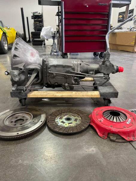

I’m compiling a list of all parts needed to do a 4spd swap in my 68 Dart GT 318. It currently has a 904 automatic. I’m trying to cover all bases parts wise for when I go to do the swap (once the heat of summer time starts to drop some). The trans and clutch was sourced from a 71 Swinger with a 340
I just bought a big pile of parts from Brewer’s that arrives tomorrow that should cover the literal nuts and bolts of the swap.
Cast iron 23 spline A833 4spd with small block bell housing.
Shifter linkage and shifter
Clutch fork and boot
Mcloed street clutch disc, pressure plate, throw out bearing, and flywheel. The flywheel has been resurfaced and I picked up a new throw out bearing.
Z Bar with service kit from brewers (pivot balls, bushings, keepers, and hardware
Brewer’s pedal assembly
Rod from pedal to Z bar and firewall boot
Rod from Z bar to clutch fork
New steel floor hump
30 spline yoke for 7260 joint and new replacement joint
Shift boot and ring that mounts to the floor
Pivot ball bracket that’s welded to the frame rail
New ARP bolts for flywheel, pressure plate bolts, bell housing to engine, and from bell housing to trans
Speedo gear O ring kit to reuse the gear in the 904. I probably need a new Speedo cable too since my current is either stuck or broken
Lower dust shield that goes under the bell housing
Bell housing starter seal
Later model pilot roller bearing
I will need new carpet of course but as far as the installation goes, it’s not technically required. I will put new carpet and also replace the current old style starter with a later starter from a magnum engine. I’m also gonna go head and put a new trans mount since mine is 50+ years old.
Am I missing anything? Any help would be appreciated. I also have a new reprint copy of the 1968 service manual.

y'all should be able to bang that out in a weekend.
remember that you'll need to shorten your driveshaft.
The 904 and A833 is the same length.. at least that’s what the resources online have told me, I just have to change the yoke to a 30 spline
ah. you're good to go then. i can never remember which-- 727 or 904 is the same length as the cog box.
Yeah I lucked out.. swap the yoke to match the 833 spline and I’ll be good to go. Once I put my 8 3/4 in, I’ll need one. I was glad that I don’t have to do that twice had it been a different length trans

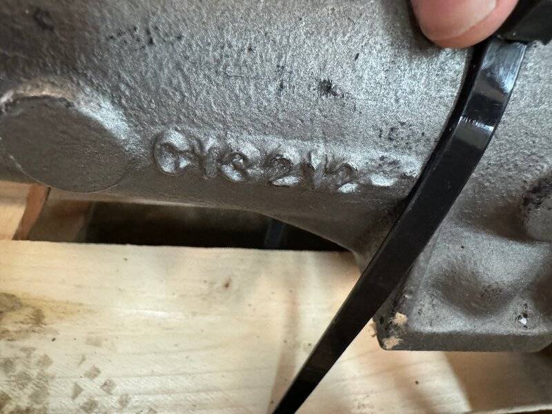

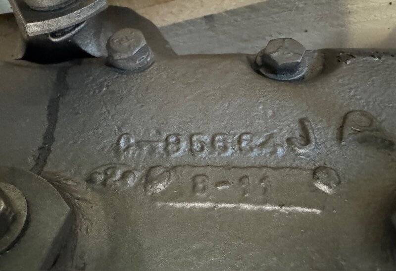

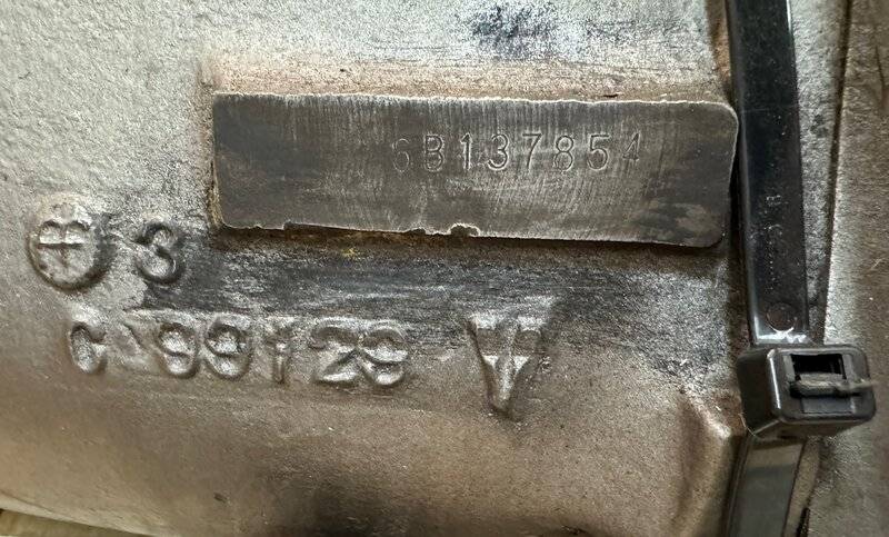

Heres some numbers off the transmission

You may get lucky and the crank is drilled for a pilot bushing since it's an early 318. Are you sure it's a 68 transmission? VIN stamp on it makes it look like a 76 maybe. I'm not up on the VIN stuff, so I'm probably wrong. If it did turn out to be a 76 model 833, it would be the OD version. Not a bad thing if you don't jerk it around much. There should be a hole in the inner fender for the ball stud, to make it easy to line the weld on bracket up before you weld it. Good luck with the swap. Two guys who aren't newbies to wrenches should easily do it in a weekend.

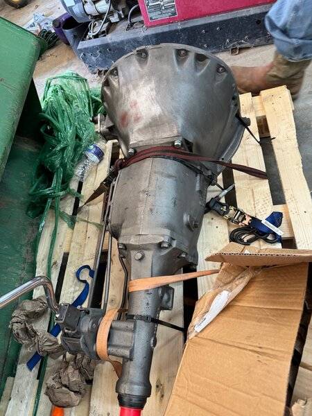

It came out of a 71 Swinger.. the number has me a bit mift because yeah.. the 6 would mean 76.. but it’s an iron case, linkage rods consistant with a non OD, and the side cover is the pre-71. I’ll go back this weekend and just spin it in 4th to see if it’s 1:1. It’s sittin on a pallet at my friends shop so I don’t have instant access to it.
They came in both iron and aluminum, I think. Check the size of the front bearing retainer. The OD trans had bigger retainers. Maybe check the bellhousing you got to see if the 2 mate up snugly.
It’s already together.. came out of a running and driving car. Previous owner went to a 727 trans.
This picture angle makes it appear that the shifter will be in the back seat ?? But as you stated it came out of a running A body . Also think your suggestion to remove the existing engine and trans to assemble before installation is a very good idea. You can check many things as stated and address them at that point. Good luck with your project.
