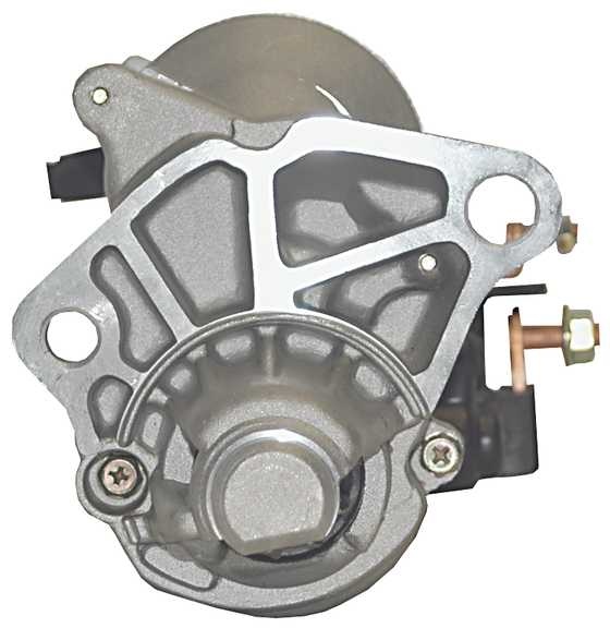

Has anyone actually tried a Mopar mini starter with the 6.1 TTI HCA headers?
In looking at the photos on NAPA, the mini starter (4N6415) looks the same as the Powermaster 9523 (without the index flange)
Looks to me like it will not work

The traditional Mopar mini starter doesn't fit unless you were to bang the heck out of one of the TTI tubes. A real nice fit is the starter for an '05 Dodge Ram 2500 with Hemi and manual transmission. If you look at page 3 of my Cuda SRT8 392 build thread, post #68 is the Mopar Performance mini starter. Doesn't fit worth crap. Post #69 shows the truck starter mounted to a truck bell housing I had planned to use before upgrading to the Lakewood scattershield. This fit would be the same as a TF727. Page 4, post 79 shows the truck starter with the scattershield. I eventually had to build a spacer because of the SPEC dual disc flywheel, but this starter would work fine with a normal flywheel or torque converter ring gear. You can get the starter via the "application" I described above or I can dig my starter out of some boxes and get the part number. PM me if you're interested.

Does this look like the one?
Part Number: NNE 4N6987
Product Line: NAPA New Electrical
IMPORTANT INFO: w/ Manual Transmission
Attributes: Starter Type : Mitsubishi Permanent Magnet Gear Reduction
Features and Benefits: Bushings: 100% New Bushings w/ Extreme Temperature Grease.
Commutators Are 100% New & Precision-Machined & Electronically Tested.
Drive Assemblies: 100% New Springs, Rollers, Covers & Extreme Temperature Grease.
Solenoids Are 100% New.
All Brushes Are 100% New High Quality Brushes.

RealWing that looks like the one. I just picked one up for mine last week from Rockauto.com for $138 shipped but that includes a $34 core. I had to cut off a couple protrusions from the block that were not needed. I have the Kiesler auto so I used a spacer to get the depth correct but it works like a charm and clears the Jeep SRT manifolds I am using easily.
Realwing,
That appears to be it. I just posted several pics of the Chrysler unit on my build thread. The Chrysler part number is 56029274AA. Not sure about aftermarket cross reference numbers. I'm happy with it for my application and I think it will work even better for yours.

Thanks for the tip. That Mopar p/n crosses to the NAPA 4N6987. Have one on order from my local NAPA store.

Had to grind the block in 3 places for clearance. Good engagement with the flywheel.
I'm going to contact TTI and get them to change their web site for these headers asap so no one else spends $$$ on a PowerMaster starter that does NOT fit - even if you reclock it!!

Forgot to add that you have to drill out the top hole in the starter. It is threaded, but the bolt threads into the bellhousing.

Big thanks to Real wing and Cuda SRT8, i brought the starter you guys used - Chrysler part number is 56029274AA, and with grinding the block like Real wing it clears, woohoo!
