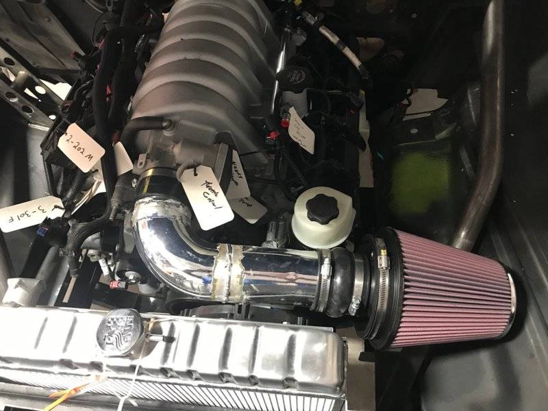

It was brought to my attention pix was not good of CAI due to orientation. So here is one right side up and tacked. Pretty pass not laid down yet. It is thin tube and grinding off their paint and primer made it even thinner and welds were contaminated due to being impregnated with factory coating. Not much material there to start with!
Are you not going to use the separator for the intake? I'm trying to figure out how to make one for when I do my intake. Can you take some dimensions of the one you have as it looks like that's what I'm looking to do.

My apologies for delayed response as I am down in Ark/Okl visiting a new grandson! I have done nothing of any value other than play cards drink beer and smoke a pork butt for pulled pork sandwiches. We rented a house on the lake and have kin folk coming in from all sides. The relentless Oklahoma vs Arkansas smack talk is over the top. Right down to origins of family recipes! As you can imagine I am having a blast surrounded by family! With regard to the separator I am not going to use it as I have purchased a after market one. For a cold beer I would send it to you! If that interests you send me a PM and we can sort it out. Please don't be alarmed if I am slow in responding I have limited internet. When I say we are from the back woods it is literal! I traded my daughters birth expenses for firewood to the doctor!

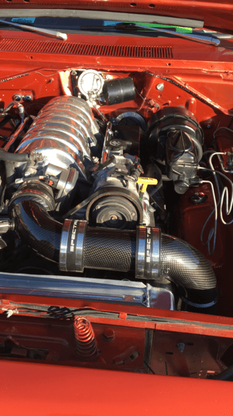

hydro dip! Is the way to go. I did my air intake hose it is PVC but you can do any material in it with numerous colors and patterns.

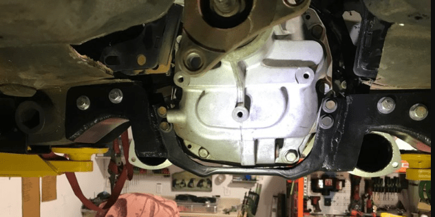

Typically a solid trans mount without solid engine mounts is a surefire way to crack an aluminum transmission case.
My trans crossmember is very simular to yours but my side crossmember bolts have urethane bushings much like the motor mounts. Just food for thought.
