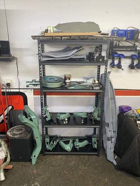

Bought this little shelf, just trying to get parts to where I can see em.

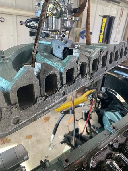

Good morning! :thumbsup: I need to pull my intake/exhaust back off to seal the studs BETTER (permatex didn't work), someone said the Remflex gasket is not re-usable? I do have one coming. But since it hasn't been ran, is it still not re-usable?
If Permatex didn't seal, something's wrong. What product did you use?
I actually was surprised that a few did leak, but it was a Permatex dark brown thick stuff. I felt I was meticulous and generous in application on the new studs bought from a member here, Badvert65, I figured I'll go ahead a remove the manifolds this afternoon~ have to meet a friend for brunch
The #2 doesn't work as well for that as the regular RTV. But you'll get it I'm sure.
I wouldn't worry about the gasket as the engine was not run.
As long as the gasket comes off in 1 piece.
Thank you both, gasser and Darter, I have the new gasket coming; guess I'll can just keep it to have it on hand.
:thankyou:
Always good to have spares.
Also after run in you will have to re tighten the bolts several times during heat cycles.
I say re tighten because a torque wrench is tough to get to (all) nuts.
Went and had a brunch with a close friend, actually Gary's friend, nice to get a little made up and it's so nice the humidity is low and my hair is straight! oh oh The gasket came apart like crazy! lol It's kind of weird material. I have the studs soaking in carb cleaner to loosen up the Permatex. I'm thinking to use a regular gasket, at least order one. The mating surfaces are clean, so maybe a regular one might seal ok? So, I've learned, you cannot reuse the Remflex gasket :lol: :lol:
Yeah they usually don't last disassembly. They're very fragile. Fragile, you know....Italian. But yeah they're made out of graphite material.
