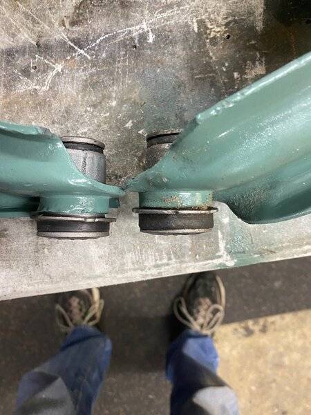

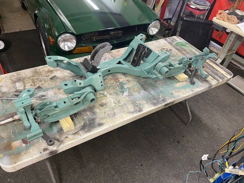

ok, I was playing with the K member. Ray, said the upper control arms/spindles won't work with my dart. I got the front spindles/uca's from the '76 Valiant. He was suggesting going with drum brakes which I have no problem with other than getting the entire setup somewhere. I don't need anything right now, it's just a concern;)
the '76 uca's just a tad wider than my 63 dart, plus the stock 63 ball joint stud is quite a bit smaller.

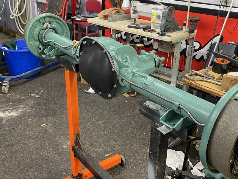

I didn't pull the parts, the guy working there did, this is where I got the rear axle of which wound up looking pretty good after a lot work.
so looks like I won't be using the '76 Valiant ucas/ and spindles

They'll work just fine. You just need the correct parts to work with them. The difference in width is probably just a minor difference in manufacturing tolerance or perhaps a collision or something. Plus, the bushing looks like it may need to be seated a little more.
So, how did I miss that! ok, I'll take a closer look tomorrow and see what gives. Thank you;)
it crossed my mind to try to spread the things apart, probably be difficult.
Nope, Couple hits with a mallet and a block of 2x4. Don't be bashful.
I used the same 74-76 A body disc brake components on both of my 63 Valiant and the 64 Dart.
The more you do the more you will see tolerances being + or - No two Mopars are exactly the same.
Yes the upper ball joint from the 63 has a smaller taper stud.
You must use the 76 Upper control arm and ball joint (Yes they do make adapter sleeves and yes they work)But you have the correct parts.
