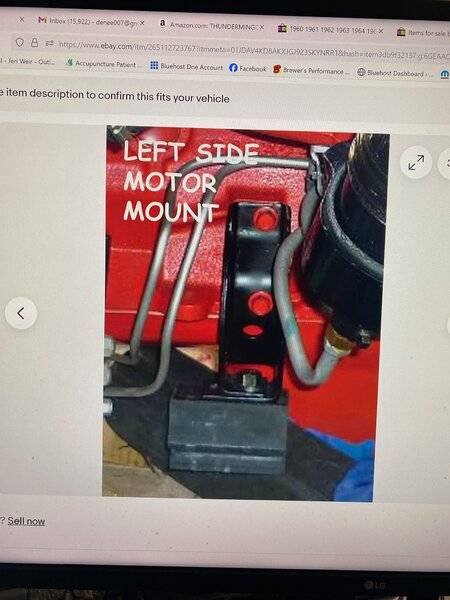

depressed, found out what the problem is with my engine supports. I didn't have the brackets and found some on Ebay quite a while ago. The ones I bought are from a '72 Plymouth valiant. So I need to find at least the drivers side bracket, the picture in the pretty red is the mount I need I believe. Little did I realize a while back on the nasty old original engine, there were a amazing amount of parts that I could have kept, including the engine supports:( I'll put out a wanted listing when we get back after next week~ and that depresses me too.
The brackets I have now
and this one, maybe I could modify them?

We've all been there....done that with stuff, so don't feel like The Lone Ranger. You won't have any trouble finding some brackets. Somebody here will have some. Most people yank a slant out of an early A and stick a small block in them, so somebody's got one laying in the corner with the right brackets. The ones that I have laying around from my /6 science project are the same as what you have or I'd already be askin for a shipping address...lol. Hang in there and just thing about how good a turkey sammich is gonna be next Friday or Saturday. :)

Early-A's have the engine set farther forward by over an inch than the '67 & up generation, which is one reason they require their own headers.....I made My DC/MP 6-into-1 headers fit My '64 GT Cpe., but it wasn't pretty, basically I'll need to cut & re-tube some sections to make it 'right'. The other reason is the Early-A's front frame rails are ~2.5" closer together, so You lose ~1&1/4" per side for clearance. Steering box & pitman arm/tie-rods are full-into the later A header tubes. I am however, plotting to move Mine back about an inch, it will require a firewall mod behind the cyl. head, & tunnel mod at the starter unless I find the mini works better there.
I may employ the later bracket w/the thick early biscuit, but the K-member has a lot of room to slot/move the mount holes fore & aft. I should have at least 2 extra Early Dr. Side brackets, I'll check in the AM,....well, later AM,.....

Here's a photo dump, early-A vs the '67 bracket, note the mount locating nubs are fore-aft(nub forward) on early-A's & lateral/up-down(nub up) on the '67 & up(pictured a '67 orange).
The green body tape indicates the proximity of the early-A K-member side stud position(My '64 GT 'vert). Also note the mount stud hole is positioned much closer to the pan rail on the later A bracket.
Early-A biscuit is ~3/8" thicker.

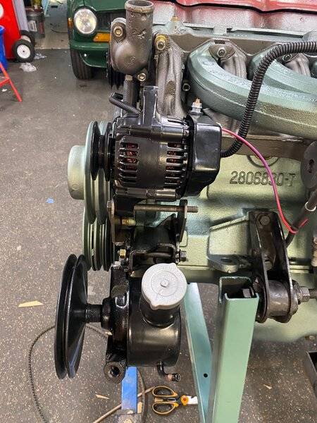

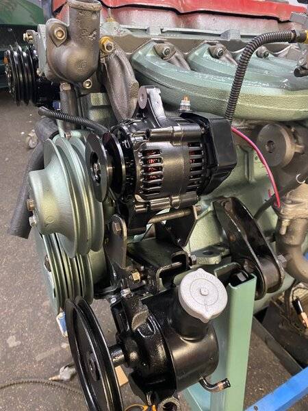

Had just enough time to work on my alternator bracket, we'll be leaving for about a week to see one of our daughters in Philly.
I have no idea how this alternator is going to do, but it will be well tested(to some degree on the ERS). Now to figure out how to wire it. I bought the 2 wire pigtail on Amazon, why don't they include that knowing that a person is going to need it. meh

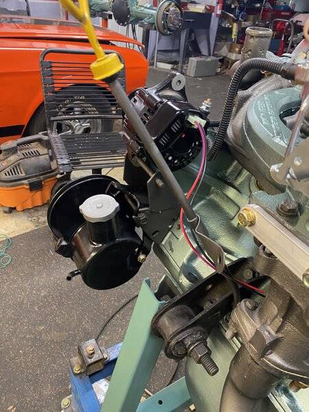

Just added bracketry onto the existing power steering bracket, the one that bolts to the block of course;)
Now I just need a spacer for the underneath of the alternator and proper sized bolt.
