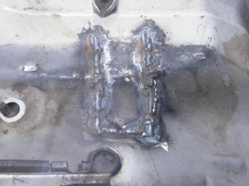

Well, I finally finished fabbing and welding in the gussets onto the passenger side brackets today. I put one on the ladder bar bracket and the shock bracket as I plan to drill a hole in the ladder bar bracket and run a bolt from the shock brackets with a spacer between the inboard shock bracket and the ladder bar bracket. It's probably overkill, but I figured better safe than sorry since the passenger side ladder bar bracket will get all of the side load from the diagonal link. The ladder bar bracket gusset may require a little bit more grinding to clear the shock, but not much.

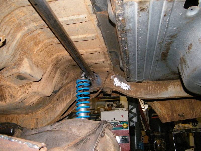

Well, before I weld everything closed, I figured I'd take and post some quick pics of old work that I never posted. Here are some pics of the homemade subframe connectors, ladderbar crossmember, and shock crosssmember installed.
I had to cut the floor for accessing the welds for the coilover shock crossmember so here is a pic of that area plus the frame rails prior to welding in the previously cut out tubs. I copied somebody else's idea on here for the frame rails. Instead of cutting the outside lip area off, where the factory spot welded it every couple inches, I made cuts in between each weld and bent the outside lip of the frame up so that it's flat on that edge, but still maintains the spot welds. Thank you to whomever's idea I copied. After I get the car done I'll have to look back through all of my subscriptions to give credit to whomever it was.

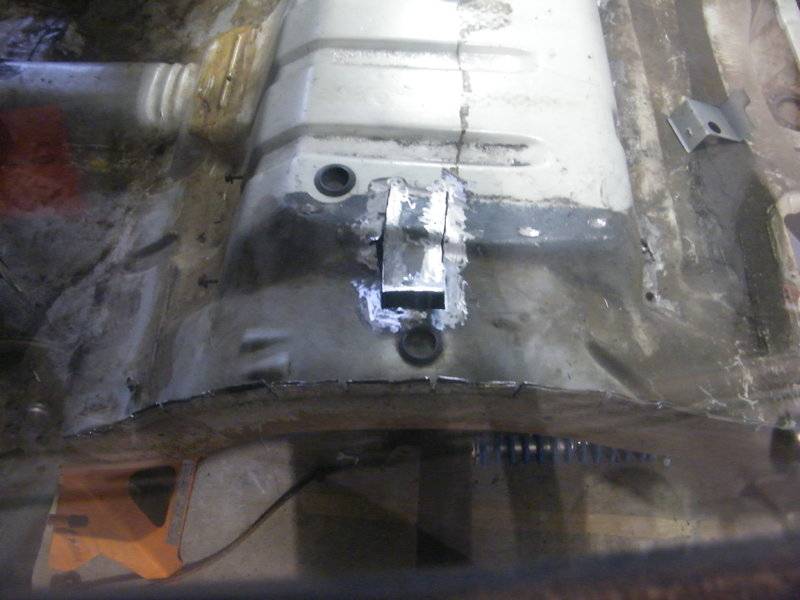

Here is everything almost fully prepped, at least the passenger side is, mocked up and also the pieces I cut off the inside of the tubs. I was going to try to cut them and reuse them to fill the open areas at the front and rear, but they aren't flat so it would have been difficult to work with them so I tossed them to the side. In the last couple pictures, you can see how I cut notches from the original body plug access holes and the 2" holes I drilled with my new hole saw 15-piece Bi-metal Hole Saw Kit for accessing the body plugs after the tubs are moved in.

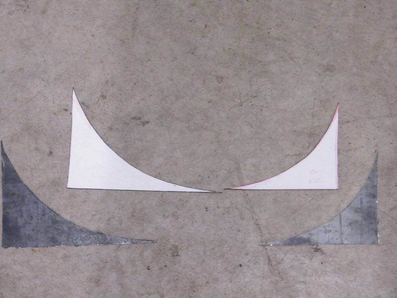

I made templates for the opening between tubs and the area they were cut from. I made them by cutting them approximately 1/2" wider than they needed to be, then taped the inside edge on top of the tub and the outside edge inside of the fender. Then I traced the inside edge from underneath the car and the outside edge from inside the car. I then cut my tracings out with scissors.
I taped them to a 16 gauge sheet of steel and traced them out. I'll be cutting them out with my scroll saw. I'm going to try to tack them in and weld them in as one piece on each side by rotating my welding points as it cools. I'll try to get them welded in later this week.

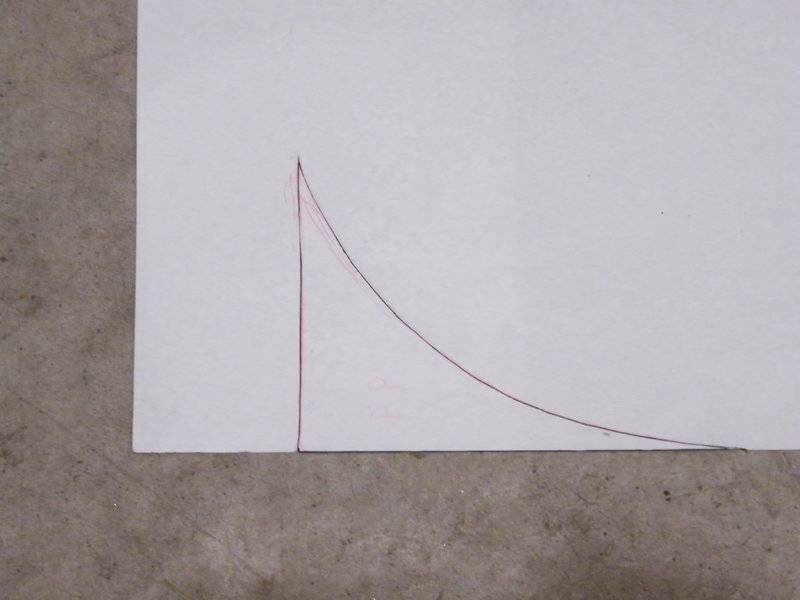

I'm going to remake the template for the driver side. I creased the paper while making it and then took the crease out when I traced it onto the metal.

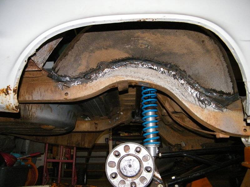

It's all sealed up now; rear axle, ladder bars, shocks, and rims/tires are all reinstalled. I now have 1.5" of room on each side of each tire with my 28 X 10.5 X 15 slicks. Once I get it on the road I'll start looking for some wider tires and possibly wider rims since my current street tires are 305 X 50 X 15.
Fortunately, all of those ugly looking welds will be covered up by carpet once I ever get to that point. I never claimed to be a good welder, I'm just hoping i burned in everything good enough to stay together.
