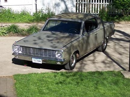

1966 Dart 270. 318. MSD Ignition setup. Just got it a couple weeks ago. Having a charging issue and for some damn reason cant get a clear bead on the bolt pattern, lol.
http://www.forabodiesonly.com/mopar/image.php?u=22596&dateline=1317850594[/IMG]
The factory wheel bolt pattern in on a 4" circle. They came in 13 X 4 1/2; 14 X 4 1/2; and 14 X 5 1/2 sizes. All were plain steel wheels. As for the charging system, get a good manual and do some testing. They're not a complex system. If you post some symtoms, we might be able to help narrow it down a bit.
