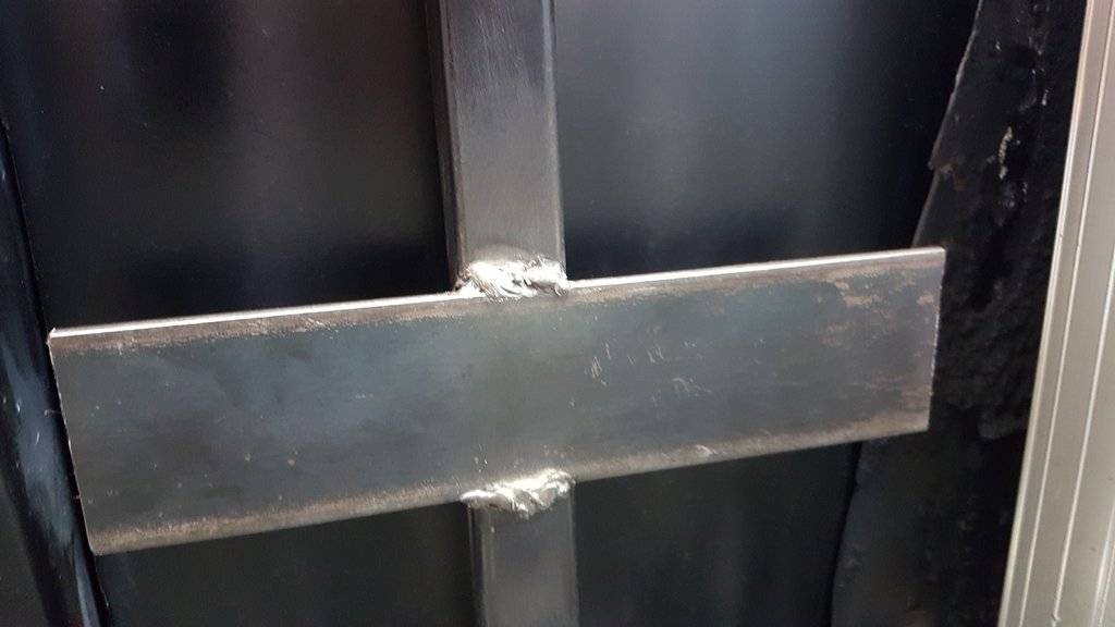

Well just some updates, bought myself a welder this week, my buddy has been nice helping me but between arranging with him and his schdule and mine, i decided to buy my own for future simple things like brackets and such untill i get better. But i welded the fuel pump bracket onto the frame we put in and mounted and pumped some of the fuel system. We also changed the end of the steering column for a better u joint and just finding a bearing for the lower portion, get rid of the plastic one, will post pics of that when its all complete, just painted everything now. The pumps are twin bosch 044 with 10an line, and a y just past the pumps.
