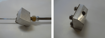

Well nust ordered this adaptor on the right of the picture, since these block have the spot for a dip stick but my machine shop didn't feel comfortable drilling it due to the angle and they can do anything. So this is a good alternative who get these blocks, and run a lokar universal or have a custom one made to match the milodon 8qt pan I will have on there, not sure where to put it though will put it all together and see where the best placement would be.
