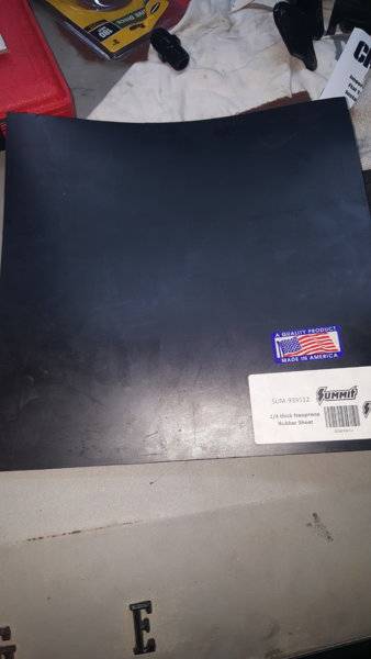

Got the billet fuel pump block off plate today along with the 1/4" rubber gasket sheet, going to have to make my own for the front China wall, and might as well make the rear out of the same material. Waiting for the head gaskets to be shipped from cometic going with .040, that's the thickness Rod from bloomers figured my 9.08:1 comp.

Got the oil filter relocation mounted, made my own gaskets for the China wall. Also swapped the braided lines on the intake to the black braided, just so it all matches the rest of the fuel system.

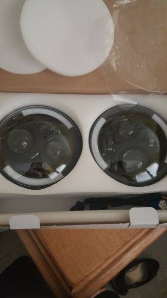

Well got the hole drilled to oil the gear drive, went through 5 drill bits to get through the 1/2 npt plug, got .042 feed oil. Also when I feel up to it, going to heli coil the front cover, already had one feel like it wants to let go brand new too, oh well. Also ordered some new headlights all Led. Hope to get my test fit liters soon from Shane and if those go in good, will order the rest, then on to meassureing and ordering some 7/16 push rods.
