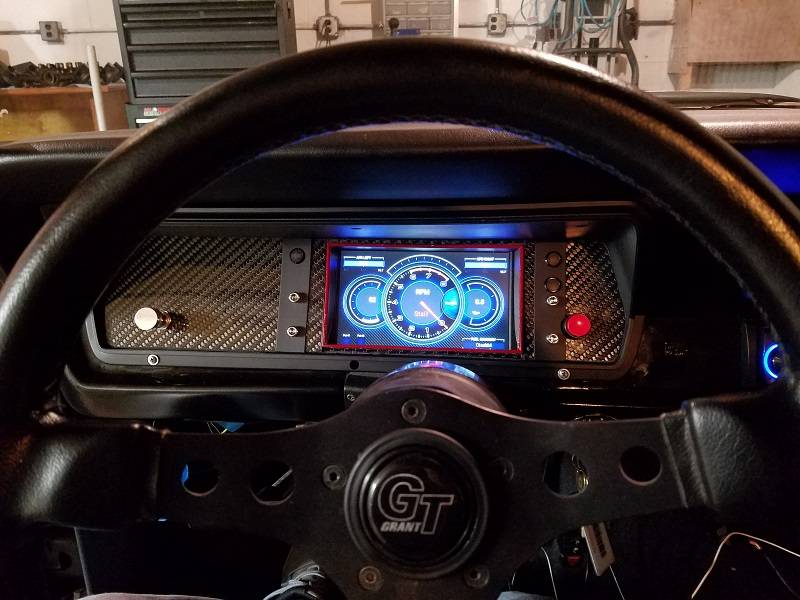

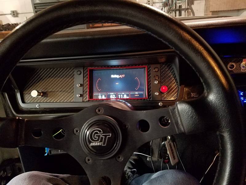

Its been awhile since I've posted anything new about the car, but I just made a change to the dash. I decided to switch to the Holley digital dash and make a new gauge cluster for it. Here are a couple of the default gauge layouts.

Thumbs up on the dash....perfect fit for your hot rod.

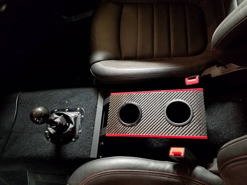

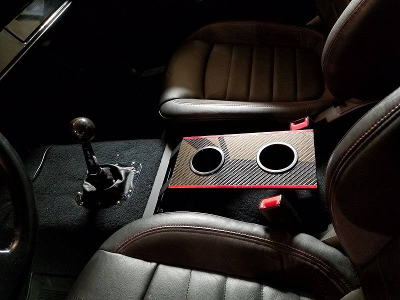

I did a bit more tinkering to make a cup holder/console. I might make a few changes, but figured I could show it off
